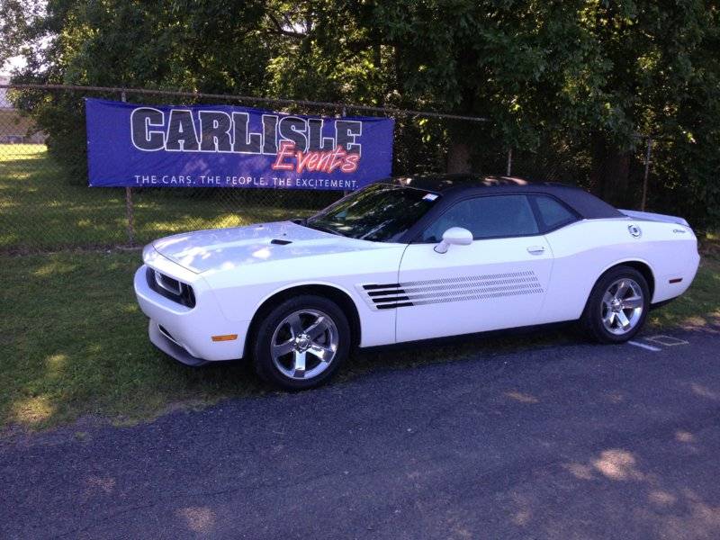

I have put many tops on non original top cars. I even put one on my new style Challenger. The drip rail moldings will work, it is just a little bit harder to get them on.

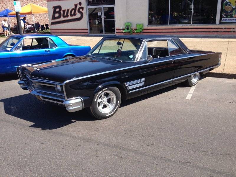

I also put a top on this 66 Chrysler 300 that was not an original vinyl top car. I used the same drip rail moldings and worked out fine. You just have to take your time and resist the urge to use a hammer. LOL.
