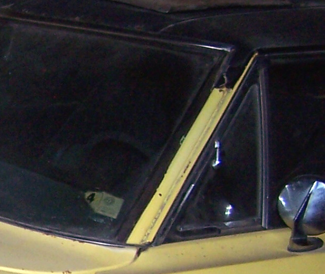

Did the Superbird-vinyltop covered a-pillar all way down behind the moldings?
No, the vinyl top stopped at the upper attachment hole for the A-Pillar molding... see attached pictures below from my Superbird. Are you restoring a Superbird?

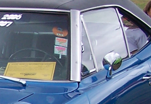

Not on a Superbird, unlike a regular Road Runner or GTX, the Superbirds had air deflector moldings that covered that area of the A-Pillar, so the vinyl top just stopped at the upper screw hole as shown in my earlier pictures. Here is a pic showing the molding installed...

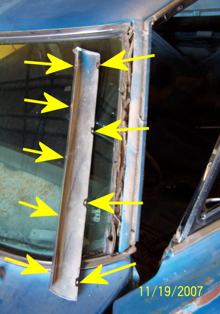

So did the daytona,s with the vinil top have the same air deflector molding?
Petty Blue 67 GTX
Petty Blue 67 GTX
No vinyl tops like Stuart said, and the air deflectors had the same shape, but attached along the edges as shown in the picture below. Chrysler simplified the attachment for the Superbird.
