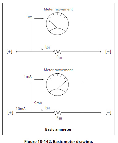

Uh, wrong again, Kimosabe. Voltmeters have SERIES resistors known as multipliers. Only current meters have shunts, which are in parallel.
A simple voltmeter circuit:
A basic current meter and shunt resistor

When you have 1mA FS meter, and measures 18V full scale, it will have a series resistor of 18K Ohms. Now, when the car is running, and charging at lets say 14.2v, that will draw 788 uA (0.788 mA). When the motor is not running, the meter will draw 666 uA (0.666 mA). It would take a very long time to drain a car battery with that load.
On this you are correct, I mis-spoke my terms. The series resistor is derived by how much current the meter reads full scale, and the voltage you want full scale to represent.
When you have 1mA FS meter, and measures 18V full scale, it will have a series resistor of 18K Ohms. Now, when the car is running, and charging at lets say 14.2 v, that will draw 788 uA (0.788 mA). When the motor is not running, the meter will draw 666 uA (0.666 mA). It would take a very long time to drain a car battery with that load.
