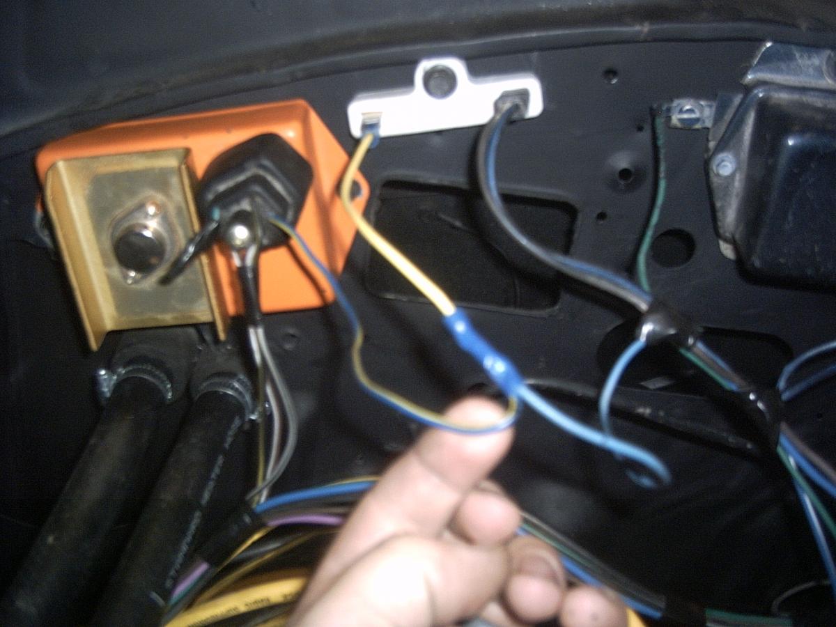

ok so coming off the fire wall on the engine harness i have a grey wire first for the oil pressure next i have a plug that has both a blue and a blue/white wire to plug onto the voltage reg then i have a green wire to screw to the voltage reg, then i have a single blue wire to the ballast resistor (this is the same blue wire that is tied in to the vol. reg.) on the other end of the ballast resistor is a blue and a brown wire. then down to the front of the motor i have a blue wire to the positive on the coil a green wire to a spade plug on the alt. and a purple and a black wire to the stud on the alt.
with the used electronic distributor i also got an orange mopar performance control module and a wire harness
for this wire harness i got 5 wires starting from the control module, 2 wires go to the distributor then i have a black wire with a tracer on it that goes to the neg on the coil a green with a red tracer that i was told to cut off and not use and a blue wire with a tracer that i was told to tap into a positive lead, it recommended the single blue wire on the ballast resistor.
i also bought a new accel super coil that gave me a new ballast resistor and also came with a short black jumper wire that i assumed was to go from the neg terminal to car for a ground
also when installing the engine/trans the ballance bar crushed in the cover of the voltage reg. about a 1/4 in (this may be the problem?) i plan on buying a new voltage reg but was unsure if i should get the one for my car or one for a car that is supposed to have electronic ign. if so what one is recommended

alright got a new voltage regulator that now no longer smokes however now the ballast resistor smokes this was a brand new one that came with my super coil
now im not positive but i dont think this system is supposed to be grounded yet if you take a volt meter from the blue single power wire to the ballast and other end to the blue and brown wires it reads 12.5 volts telling me its grounded some where so in order to figure out where it was grounding out i seperated the blue and brown wire and traced the ground back to the black and yellow wire from the control module i dont think this is supposed to be a ground so any thoughts???
i have two control modules both of them cause the resistor to smoke and over heat within 20 seconds i just had both of them tested and they both test fine im lost plz help

A new ballast resistor letting out some initial smoke may be normal since a resistor is basically a heater, but after a while I would expect it to stop. If you have a short or a coil with too low resistance you will get more current flow and more heat.
The green wire from the regulator should go to the field (F) terminal of the alternator (not to ground) and the other wire should be 12V from the ignition.
well since i last posted i bought a wiring schematic for a 70 as well and in that schematic it shows the alt as having 2 fields, not wired the same therefore im pretty certain that running the 70 and newer vr and connecting it like my 69 was supposed to that was my problem but rather than guessing and checking more i opted out for the easy solution and bought an internally regulated alt. from summit. :)
