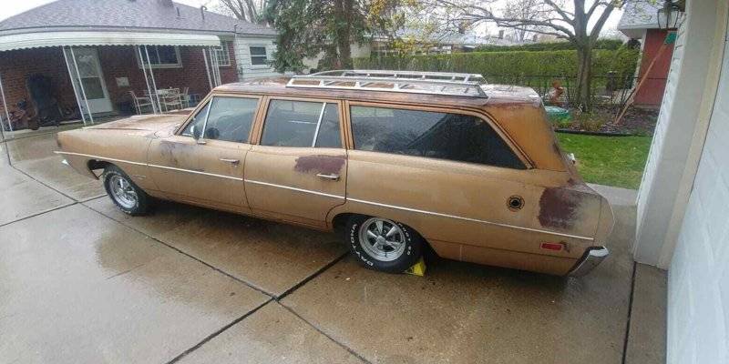

Just scored a 1969 Coronet wagon, needs floors, transition pans, etc, rails are good, 1/4s and trunk are mint....a few questions:...Are the available floors for a DODGE from AMD the right length to work in a wagon and can you get the entire floorpan to fit thru the rear opening of the wagon? There is no getting it thru the sides because of the posts, so does anyone here have that knowledge? I am aware that there are differences in lengths between the Plymouths and dodges, but the wagons all use the 117 WB.... thanks!

Pretty sure the floor pans are the same up to the hump over the rear end.
Congratulations, that first picture. Is it from That 70’s Show ?
68-70 wagons have the same floor as 66/67 all B body.
I also believe the WB difference between the Dodge and Plymouth B bodies was all in the spring hangers and not the pans and framerails
