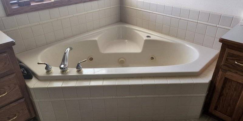

While this isn’t a walk-in, we had a whirlpool installed when building the house, oversize unit, thinking how great it will be. Well, in 24 years we’ve used it maybe five times. We’re on well/septic, but some friends are paying a fortune for water today on sewer/water not using theirs. Just redid our shower for too much money deleting the old fiberglass module. Nothing like a hot tub when I’ve been in them; but by the time I get the whirlpool filled I’ve lost interest, lol. Always thought of converting the thing to be a hot tub; not exactly been recommended..

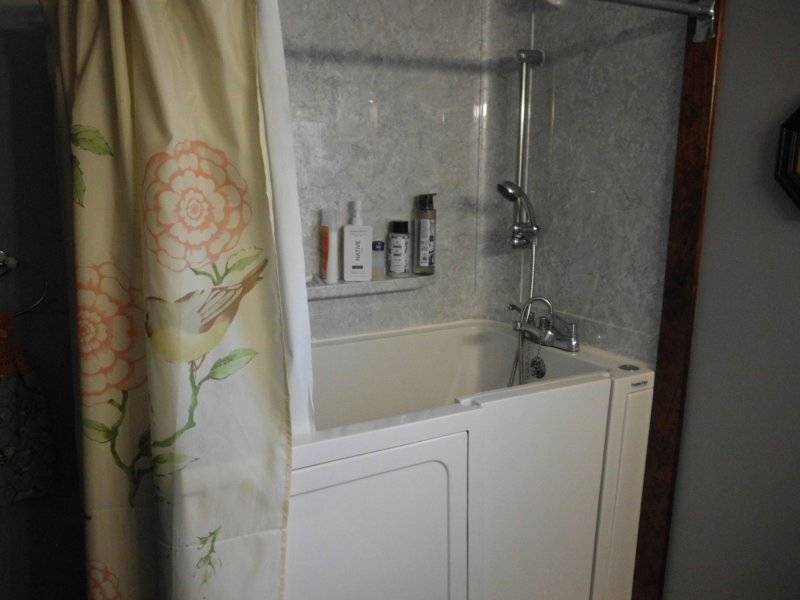

I put this in for my wife about 6 years ago. Her knees were preventing her from stepping over a tub side and she was looking for the ability to soak. The shower concept is good but you can't soak in them.
I had sticker shock when 1st pricing these out. Then checked craigslist and found several listed by people who'd purchased places and were installing a more traditional tub/shower setup. Bought this one, already removed, just about brand new, for less than half the price of a new one. It sounds morbid buy many of these are installed for people with one foot in the grave and don't see much use. I was concerned about leaking and studied the various door seal arrangements different suppliers used. I was impressed with this one. The whole unit is well built and quite sturdy. I was also concerned about the door warping from use, but haven't encountered any of that. One slight leak after about two years of use on the connection to one of the water jets. Took me longer to find the leak than to fix it.
Wife loves it. Fills it up and uses Epsom salts and sits in there and reads. She used to talk on the portable phone but after dropping it in the water twice (first time I was able to dry it out and it still worked) she gave up on that idea. I've even seen her sleeping in it.
Only caution I would pass along is check your hot water heater capacity. With a small unit, you could run out of hot water before it's filled up completely. It's a bit small for a full gown guy taking a stand up shower in it. I have a full shower downstairs so wasn't worried about that.
This one could be removed in less than 2 hrs of work, so would not present a big obstacle for the future buyer.
