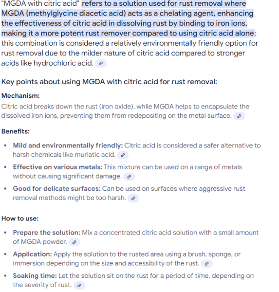

Guys the active ingredient in Evaporust is Disodium EDTA a white powder mixed with water. available by whole sale chemical suppliers or ebay or amazon But citric acid is a whole lot cheaper and just as effective as evaporust in my opinion. A friend who is a chemist at work says evaporust may have changed to a newer formula called MGDAand neutralized citric acid. MGDA can be purchaed from amazon but also is very expensive

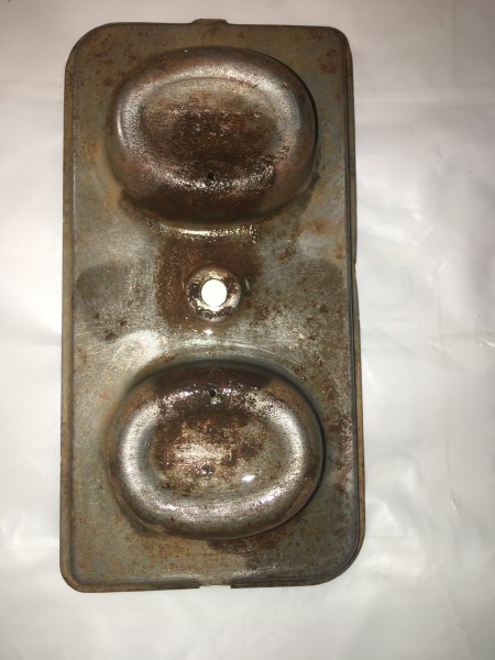

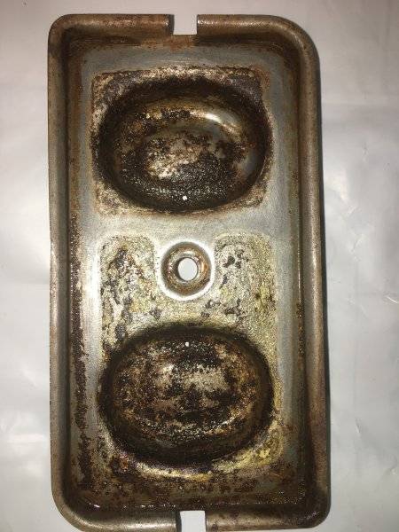

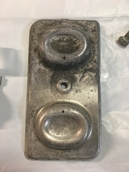

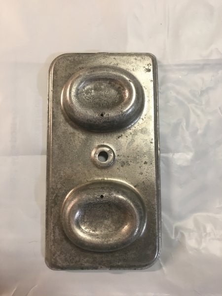

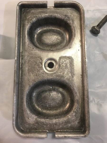

Using a dilute nearly-neutral citric acid solution produced the following results (refer to before and after images) on a master cylinder cover. The cover was degreased and scrubbed with a wire brush, prior to 24 hours of treatment. The result still comes out dark (coated with black iron oxide) but easily cleans off if you can reach the areas with soapy water and a wire brush. Observe how the shiny surfaces (where present under the rust) are preserved. The majority of rust products using phosphoric acid (naval jelly, POR-15, EIS Rust Raider, etc.) etch and dull the shiny surfaces. Note I snapped a photo of where I cleaned the black oxide only part way, for contrast.

Using a dilute nearly-neutral citric acid solution produced the following results (refer to before and after images) on a master cylinder cover. The cover was degreased and scrubbed with a wire brush, prior to 24 hours of treatment. The result still comes out dark (coated with black iron oxide) but easily cleans off if you can reach the areas with soapy water and a wire brush. Observe how the shiny surfaces (where present under the rust) are preserved. The majority of rust products using phosphoric acid (naval jelly, POR-15, EIS Rust Raider, etc.) etch and dull the shiny surfaces. Note I snapped a photo of the where I cleaned the black oxide only part way, for contrast.
View attachment 1778304View attachment 1778306View attachment 1778308View attachment 1778309View attachment 1778311
Rishi one of my fellow workers has a spectro to analyze the product that's where we got he got the data. Its a few years since he did the work. Recently he felt it is methylglycinediacetic acid trisodium salt, with a reacted citric acid.
Nice data. Thank you.
