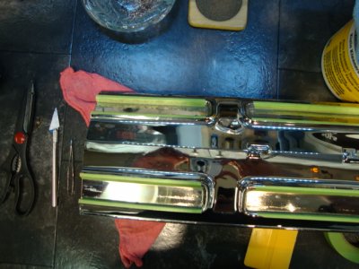

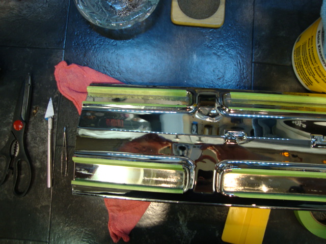

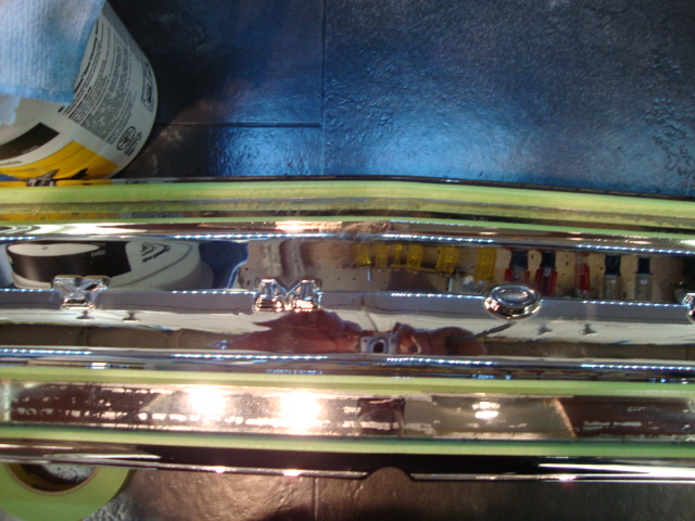

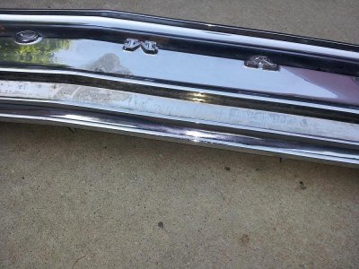

Shopping spree @ Menards today!!!
so i went to Menards today and they had this "Frog" brand tape (on the order of the green 3M), but it has a little more stretch with good tack and no residue also. :toothy6:

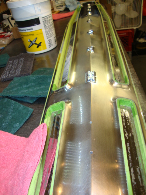

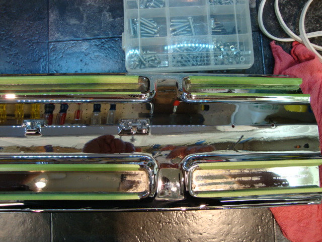

yesterday i started masking the GTX panel with the light green 3M masking tape (which holds a straight line very nicely btw).
then masked the corners today with the darker green "Frog Tape"...very nice and workable, but yet tacky. :hello2:
it took a little help from an x-acto knife and tweezers, but i got it as close as i could!! lol
patience, grasshoppa!! :icon_bounce:

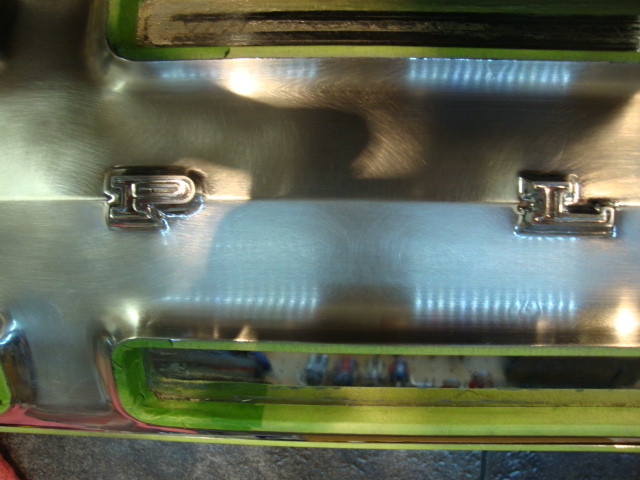

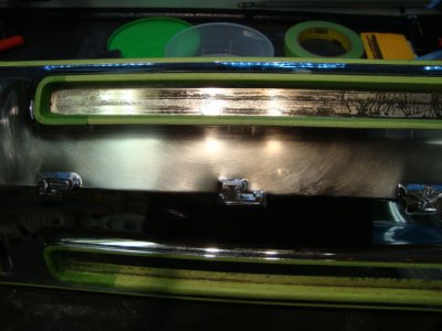

so how much do i really have to scuff it?? is it more of a sanding off job, or more of a dull the chrome out job?
reason i ask is, ive scuffed the hell out of it with the green 3m pad, and the shiny is gone, but you can still see the reflection of something in it.
thanks guys!!! :headbang:

That looks good to me.Now make sure you wipe it down a few times with some grease and wax remover before you spray it.You dont want to go through it all to have fish eyes appear.
sweeeeeet! thanks Jay. ya i purchased a dupli-color "prep-spray" allegedly it removes grease and wax lol. also purchased da dupli-color self-etching primer.

You can use the "prep Spray", but don't use the self-etching primer!!!! Nothing out of a rattle can will stay down under the lacquer-based Argent! That primer is probably enamel based. I have a quart of the PPG "Duracryl acrylic Lacquer original argent from Year One I purchased about 15 years ago, but don't want to open it until I spray my pieces because once the air hits it will probably go bad soon after. Try to have some mixed up by maybe Ketone? If you can find someone who has the mixing components, they can do it. I'll try and find you some. Don't be in a hurry!
There's a guy on E-bay from Canada whos selling the correct rough finish silver argent in rattle cans. It's not cheap, I think I paid lke $15 a can for it, but it's good, it's held up for 2 years now. The one thing I found about it is that one or MAYBE 2 coats and it was done. When I put the 3rd coat on, it flowed, smoothed out a whole lot. Still looks good, just not as rough as it should be. It's a good option for someone who doesn't have spray equipment, or just wants an easy way of doing it. One can will more than do the panel. I bought 2 just in case and didnt need the 2nd can
