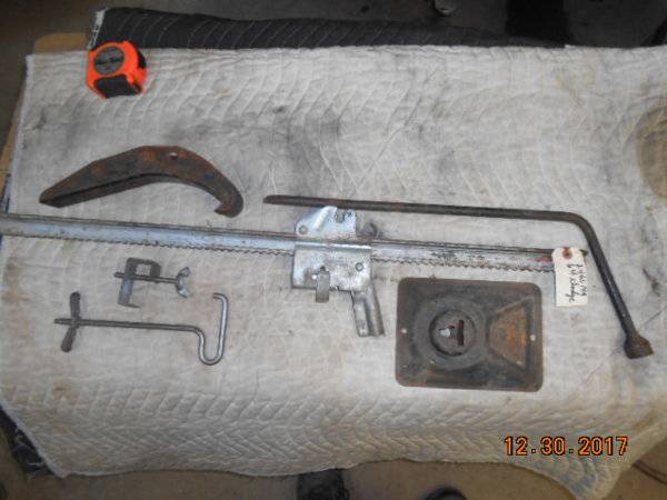

I'd appreciate it if any Members owning a '64 Polara with the correct Jack Assembly in their car could provide me with the following information:
1. Length of the Mast
2. Jack Hook part number
Looking at the Nick's Garage site [http://www.nicksgarage.com/jacks.htm], he lists 3 different Hook part numbers for the 1964 B Bodies so I think it's reasonable to assume that there are differences between all 3. His webpage also says (to Nick's credit) that his information may not be 100% correct, so I'd appreciate anyone here who can confirm [or correct] his information.

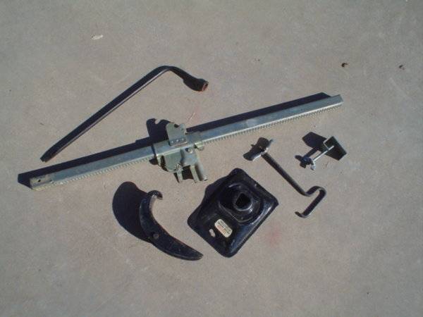

The attached pic shows the components of a 64 Polara Jack Assembly but the shape of the hook in the photo might not be right. Thanks!
looks exactly like my 63 polara
According to Nick's website, your hook should be #2266627 and the '64 hook is a different number. There are no pic's of a '64 Hook on Nick's site so I can't say if they're the same except for a part number change or not.

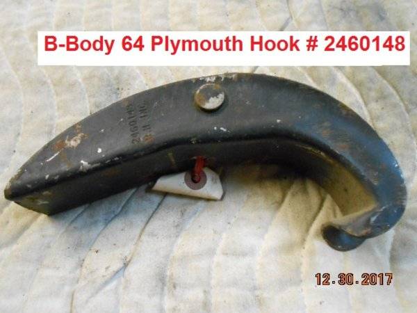

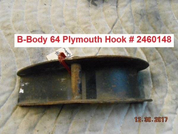

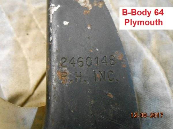

I just sent photos to Nick to add to his site for p/n 2460148, 1964 Plymouth b body, except station wagon which would be different. The Dodge p/n for 1964 b body is 2460149 and I believe identical in shape, fit and function of the Plymouth hook, only difference being the part number.
The mast I have and I believe it to be correct is 34" long. Could not find a part number on the base. (probably too generic and used on multiple vehicles)

Dodge, Plymouth & Chrysler are all separate divisions and don't share part numbers-maybe some exceptions ?. It also gave the seperate divisions autonomy to source parts from different vendors. Example: The jack base could be shared on many different models A,B & C bodies. Only variable would be the mast length & hook which would be bumper style specific. The bumper style would require a specific hook design. If you look at 64 Dodge Polara bumper compared to a 64 Fury bumper they are almost identical.
I also looked all over the place for 2460149 without success. Searched old wrecking yards, Ebay, Mopar forums, Wildcat Auto Wrecking (mopars only) is fairly close to me and they had no clue either. The 2460148 Plymouth hook fits my Polara bumpers just fine so that's why I gave up and stopped searching.

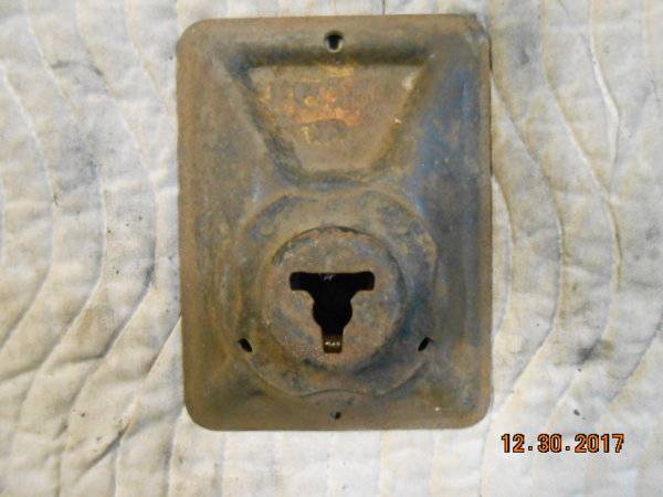

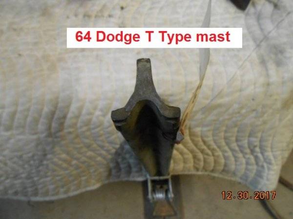

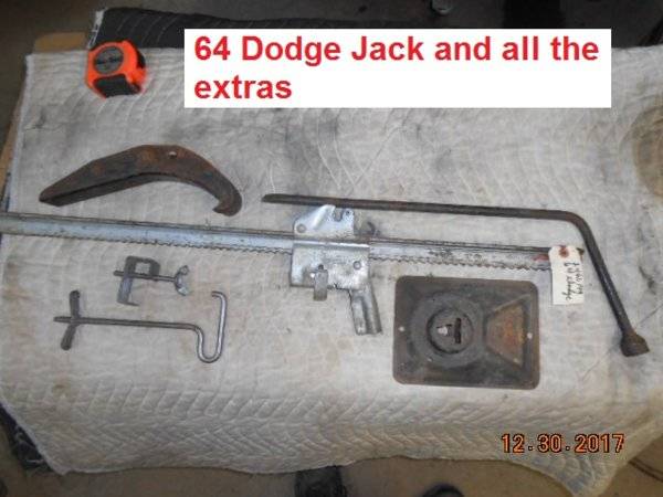

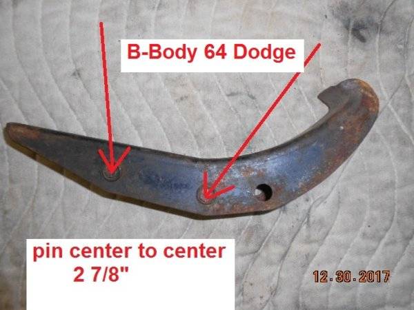

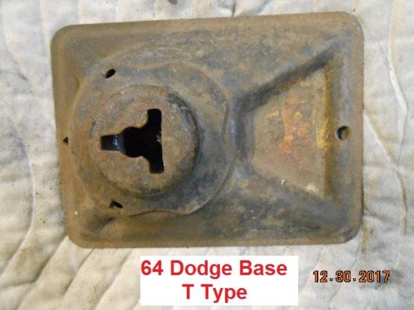

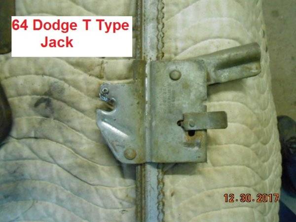

I have 2 64 Dodge jacks that I took out of original cars years ago. I believe these hooks to be correct being that they are both identical. All the parts are the same except the length of the masts, are a difference of 5/16".

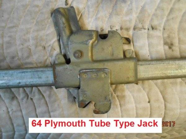

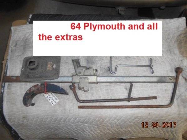

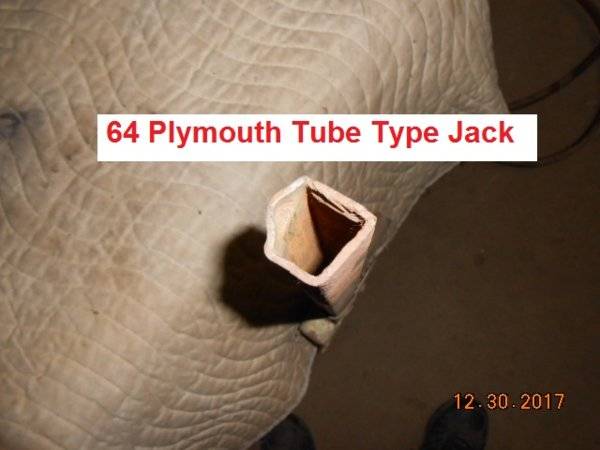

1-Mast Length 1-33 5/16 2-33 5/8 64 Dodge T style 64 Plymouth Tube style jack
2-There is no part#stamped on the Dodge hook and it is a 2 stage hook.

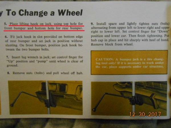

The pictures and literature above are from the 64 Dodge glovebox book.
NOTE

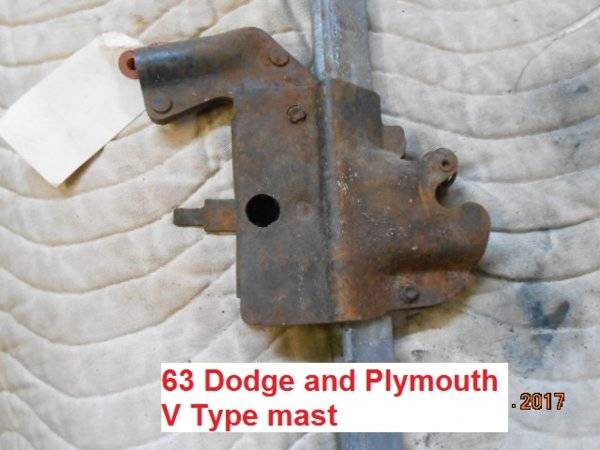

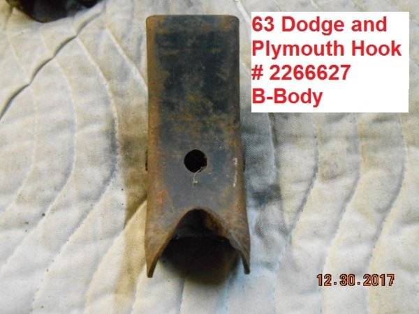

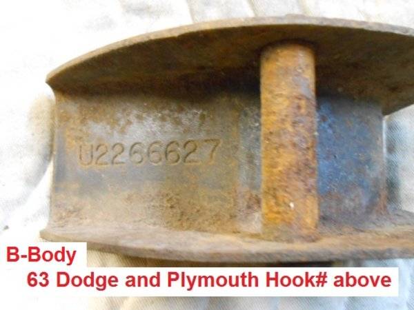

63 Dodge and Plymouth used the same jack. Hook#2266627
64 Dodge and Plymouth used different masts and hooks. Dodge Hook#2460149 and Plymouth Hook#2460148

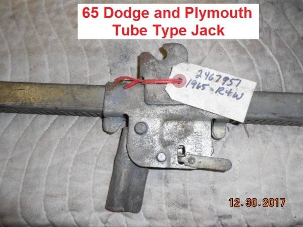

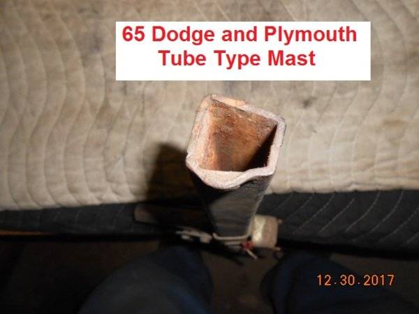

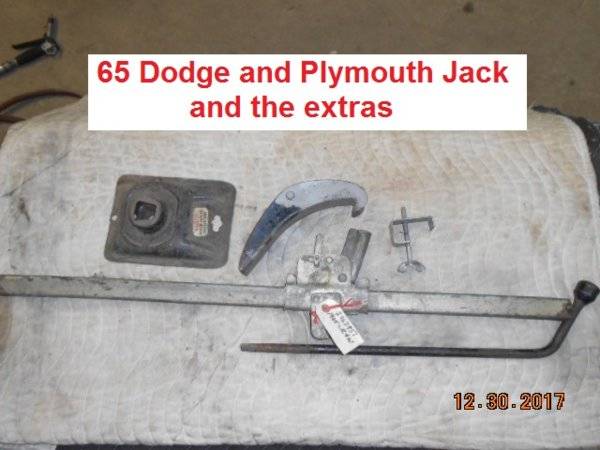

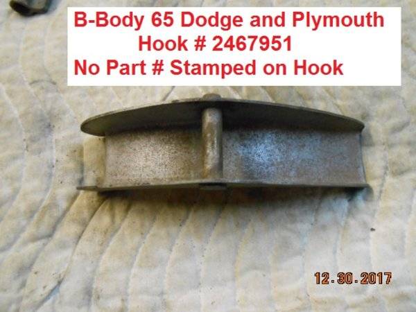

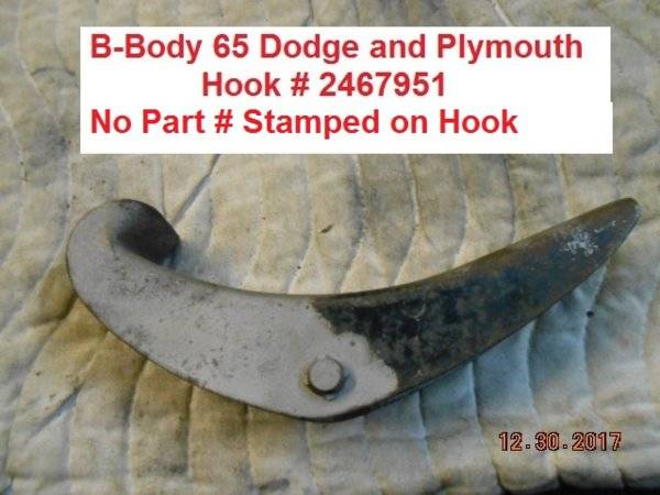

65 Dodge and Plymouth used the same jack. Hook#2467951

But if you don't want to sell, then could you please take a center to center measurement for me between the 2 round 'pins' in the Dodge Hook? That measurement, combined with your photo's, will help me look for the correct part next July at Carlisle.

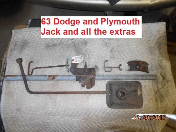

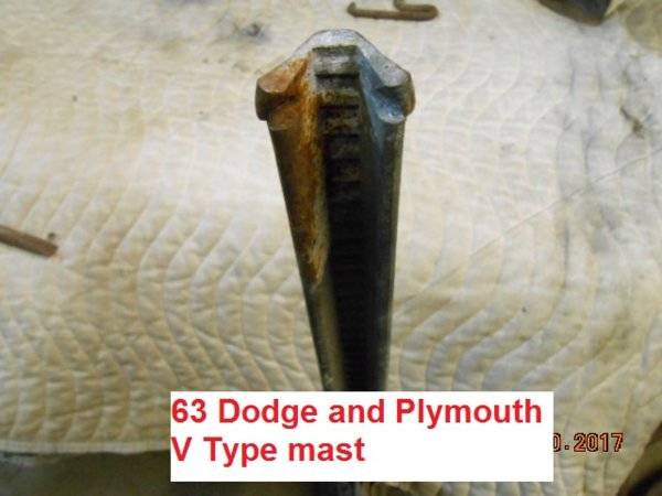

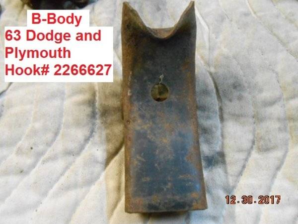

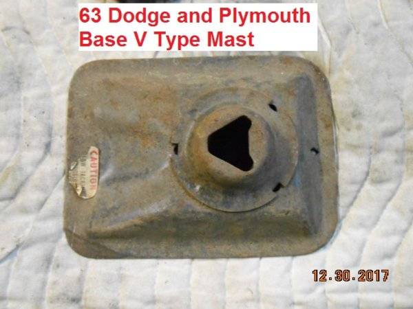

Here are pictures of 63 B-Body Dodge and Plymouth jacks.
They are as removed from the cars.
Jeff

Here are pictures of 64 B-Body Dodge jack.
Jeff

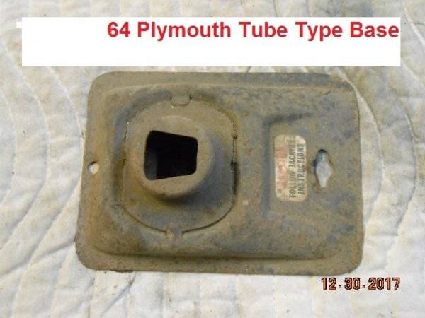

Here are pictures of 64 B-Body Plymouth jack.
Jeff

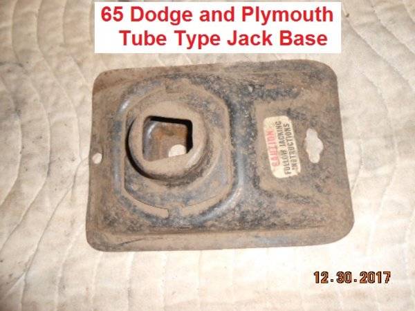

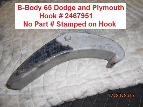

Here are pictures of 65 B-Body Dodge and Plymouth jacks.
Jeff

I have 2 complete jack assembly's one from a 63 dodge measures 34.5 and one from a 64 dart measures 33.5.
