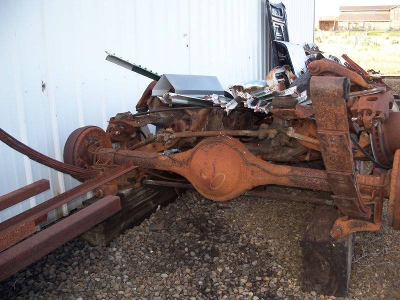

I have one I pulled out of a 73 Road Runner back in the 80's, used it in a 74 for a while then parted that out. I am just outside of Boise ID. I wouldn't have a clue as to what to ask for it, they are not cheap anymore. I am pretty sure it is a suregrip, probably a 3.23.

I got the springs off the differential. Both drums came off easy. Still has material on the shoes so inside of drums look good, I did not measure them. All springs and brake parts look good. Right axle seal is wet. It is a 489 case.
I turned it several times and it came out to 3 1/4 turns so it is a 3.23 ratio. I checked the turning torque on the sure grip and it is 10 ft lbs to break it loose, holding the pinion with a pipe wrench. I believe that is the cone type specs, correct me if I'm wrong.
You would get everything in the picture, drum to drum (well except the chain and the tractor). Both brake cables are free, pull easily. Pinion snubber also, brake lines all look good, vent is good. Rubber line is junk though. Whole thing is $1000. If other members think I'm way out of line on price I might be negotiable, I don't really have to sell it.
