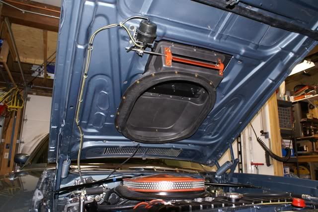

The correct one year only (’72) fender braces do not interfere with the Air Grabber. The ‘72 passenger side brace has a slight bend midway to accommodate the air box seal flange. The braces in ’72 where installed at factory originally on all big block cars only, arguably some 340 cars as well some will say.
There is no reason the original style AG parts won’t fit a ’72 Satellite, braces or not. Obviously the hood will need some modifications, hood pictured uses original parts and a modified original Satellite flat hood.
