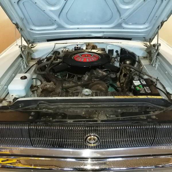

On my 67 Coronet RT there are the 2 metal clamps to secure the washer hose. Could someone take a picture to show location for me.
Thanks Dan
On top of the cowl panel,just below where the hood sits when open or closed by the washer squirters. You'll see the holes
They must have been covered over during body , I don’t have any empty holes on top of that cowl area
You can see the washer hose routing here. The clips are a few inches to the left of the nozzles on both sides.

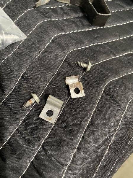

Can you feel under the channel where the mud oozed out for their old location? I'd have to take a pic of my 70 if needed
I have both 66 and 67 i can take a picture and measurements later today if no one gets them sooner
