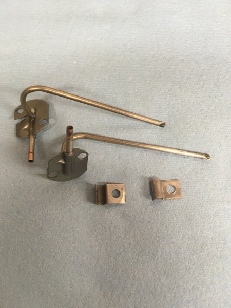

Been helped many times by others with stuff like this on the forum. Hope this helps you. These are the nozzles & clips from my 69RR. They attach with (7) #10-14x .50 lg pan head Phillips screws. If I recall correctly, the original rubber hoses are ribbed on one half side & are two different sizes. Heard a while back that Frank Badelson might sell the correct hose...jim

thank you this is very helpful.
