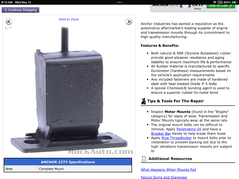

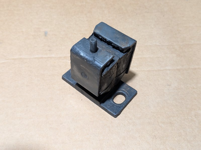

The described spacers were not used on the 1969 B-body transmission and crossmember with this style of insulator, or mount, part number 2533145, shown in the following image:

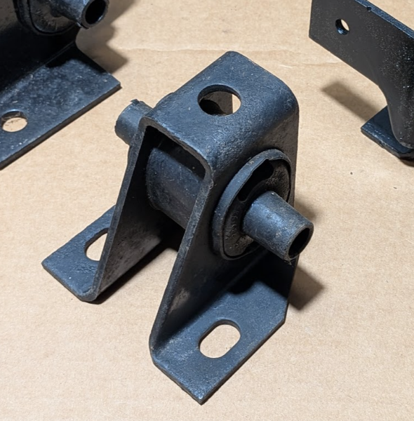

The spacers first appeared on the 1969 C-body and D-body with the spool type mount, part number 2892471, as shown in the following image:

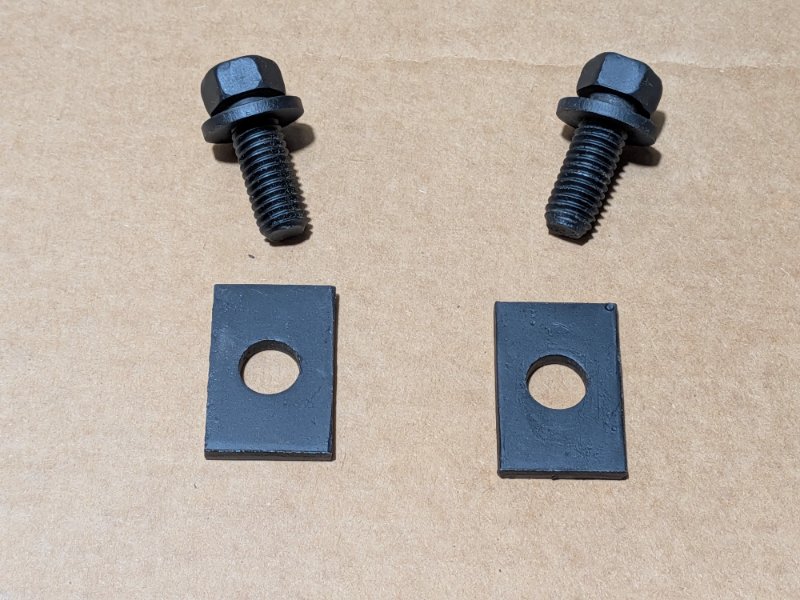

The rectangular pieces were called spacers by Chrysler. Although they perform as an added, broader, washer for better clamping, they also space the bolts out to ensure the same bolts used prior do not bottom out in the transmission extension housing. The spool mount bracket is thinner than the earlier mount. The following image shows the spacers, part number 3410700, and bolts:

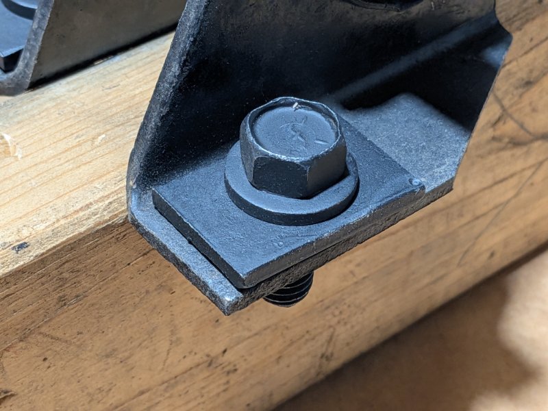

The spacers and bolts attach to the mount bracket as shown in the following image:
More information about the spool type mount:
The usage of the spool type mount spread to other body styles over the next few years, replacing the 2533145 mount, as listed in the following:

The spool mount changed some over the years, but the basic function and layout remained the same. The spacers and bolts remained the same. The C-body and D-body started with bolts in 1969, but shifted to studs and nuts in 1970 and later.

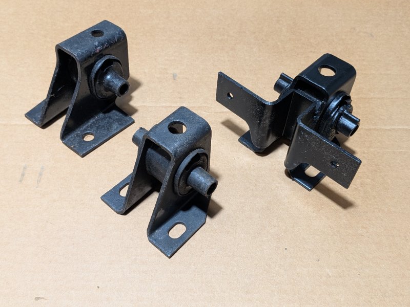

The following image shows some of the spool type mount variations:
Left is a truck mount. Center is the basic car mount. Right is the later car mount with the added support bracket.
