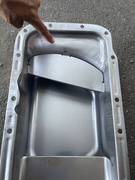

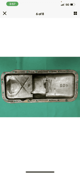

.........I spoke to the guy and told him I had a 402 pan and I had ordered the oil slinger so I asked and he said he had a pan that would fit and was a replacement for the 402 pan...........
So what was the 440 Source part number they sent you? Maybe you can help someone else avoid the same boondoggle.
Pan number is 200-1123
Was told it would replace 402 pan for b body satellite 1970
single gasket no windage tray
here’s a pic 402 pan and 440 source pan

So you got rid of a four quart oil pan & got a 6 quart oil pan & your not happy......

No no I just wanted a replacement 402 pan that was straight and new and they said this was it. So I’m just bothered about having to pay shipping back on an item I was told would fit and how they handled the situation. Is what it is

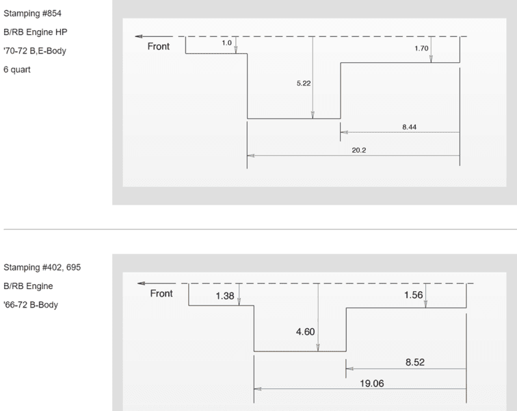

So the front of the Source bucket doesn't fit the K member or the oil pick-up strainer is the issue?
My guess is the bucket part he says it’s the oil pick up. The other guy says it should fit (seems there’s two guys working there) regardless but there’s no way this will fit. guy one says modify or get the pick up tube I do t want to modify because once I do I own it and two they should have told me this before I purchase it or take the item back accept the mistake they made and cover shipping costs back
I used their 402 pan and matching pick up on my 470 with a QA1 k frame, fit perfectly.
They said they didnt have a 402 pan and that the company that reproduced 402 pans went under but recommended the pan they sent would fit after I received the pan and verified it wouldn’t fit I was told I needed their pick up tube so I installed mine back and they’ll give me a refund if I pay for shipping on their mistake. I just wanted a pan that would fit that’s all

Yeah this was in the last three weeks. shame too because it’s a decent looking pan, now I’m stuck using mine again praying it doesn’t leak again
The pan you have will fit, takes a different pick up but it fits B & E body K members & it holds more oil which is a good thing...
Ain't no way I want a 402 pan on a 470 engine... If you suck the pan dry on a speed run things can get ugly... Couple extra quarts is a good safely margin....
