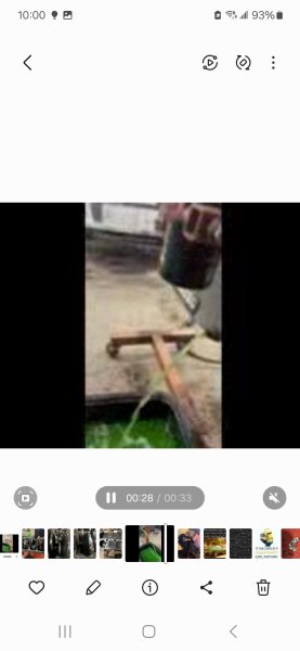

Spun the engine on its back and pulled the four oil pan bolts .... And I find water in the pan!!!
I mean about a quart pouring out of of the block!
#2+4+6 pistons are filled with water .
This engine never sat outside since I owned it. I had the pan off of this motor two months ago...no water anywhere.
It's an oil and water mix. Never got near any water. The block was dry when I installed the freeze plugs yesterday.
I never poured any oil into the engine except for a little assembly lube squirted on the camshaft and lifters.
I'm stumped. WTF?
Look at the video...what a mess.
