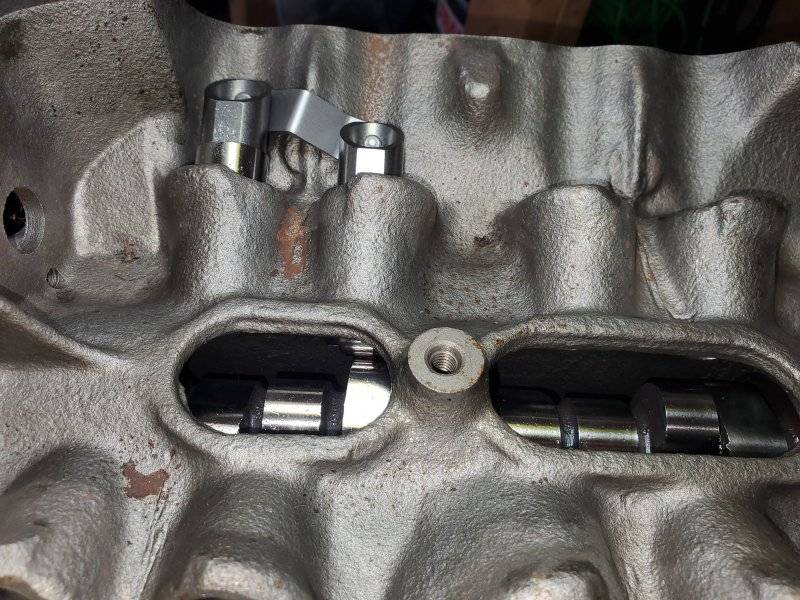

I have a call in to jegs right now. Waiting to hear back. Any idea why that lifter would be riding on the edge of the cam lobe like that?
put the front thrust plate on the block and the top timing gear... so the came is int he right spot.. betting you have it pushed too deep in the block right now.

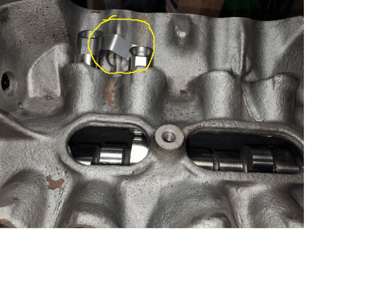

Also check every lifter to make sure that bar isn't hitting that raised ridge... might need some grinding

Okay. Yeah it definitely seems like it's too deep. I did not know that was a thing though. Thank you so much. I'll check that out
Yeah I saw some videos where someone had to do that. Seems like it's fine for mine though. It's a tight fit but there dosent seem to be ant issues. Will that need the spider hold down thing? Will that still work with these lifters and 1.6 ratio Ricker arms?

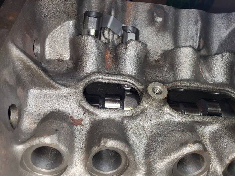

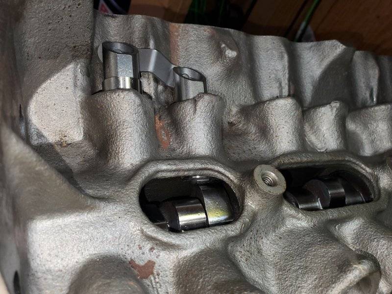

It looks like all the lobes don't line up with the lifter bores.... only reason would be came not in all the way or too deep that i know of...
Also in the second pic is that a crack in the lifter bore? sure looks like one...
I said the same thing and freaked out last nigh. It was a peice of wire bristle in the lifter bore. The engine is right next to my wire wheel. I'm going to go through it with a fine toothed comb before I do anything else to make sure there's not more

No spider needed with those, the link bar keeps them from turning in the bores.

So when I put it in. I lubed the hell out of it an pushed it in as far as I could. Your saying it's highly possible that it's too far back in the journal. Is there anything that is supposed to be put on the back of it to keep it in line perfectly. Or does the oiling gear keep it pressed against the thrust plate. Because looking at the pictures it seems like moving it back towards the front would solve my issue
