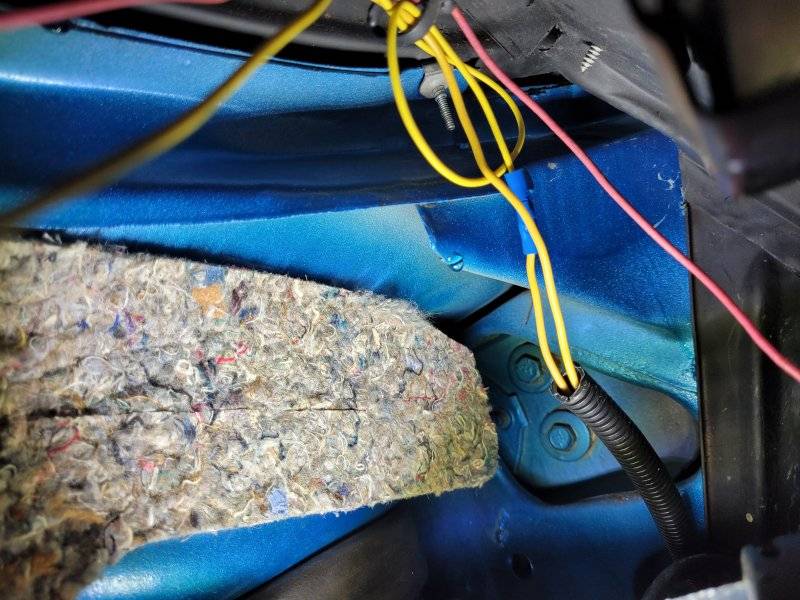

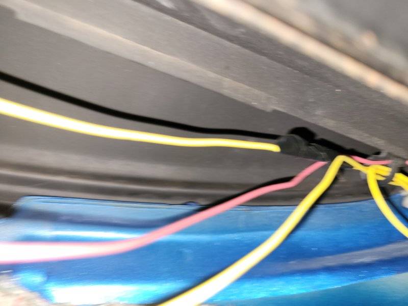

But, I did discover additional leaks under the dash along some "pinch welds". I think I need to spend more time sealing along the bottom of the A pillar on the exterior. Have added some photos of the leaking area. Maybe someone has been down this road before and can "confirm" the possible source of the leak. Not the best pictures I have taken. Will see if I can improve on them Here are the fist versions.
