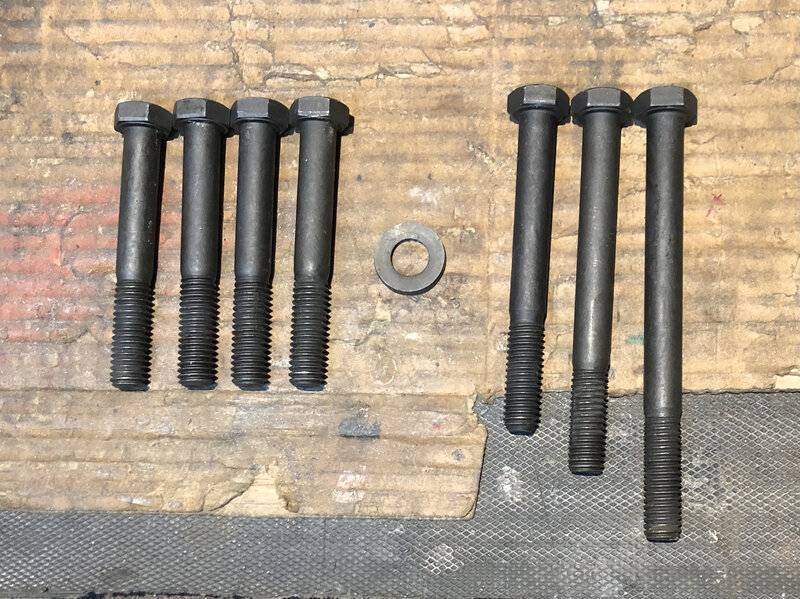

I have the correct set of water pump housing to engine block bolts from AMK.
Going on a 68 383 block.
The set contains of
4x short bolts (2.7")
3x longer bolts all of different length (4.2", 3.6", 3.2")
1x washer
Can you please say me the correct position of each bolt and which bolt uses the washer?
Thanks

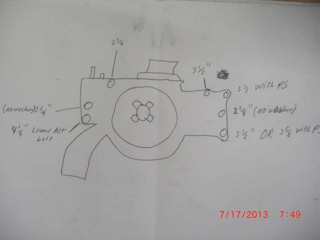

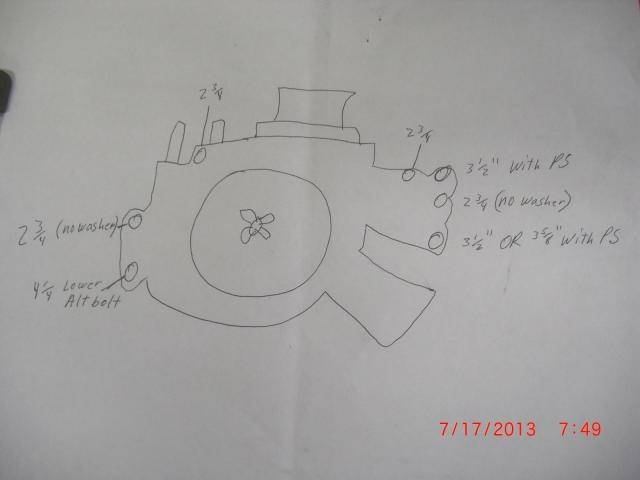

I found this on the A bodies site for a 440. Should be the same for your 383. Not sure why there are 2 variations.
That drawing looks like it could have been drawn by a six year old! :D
I always just use what fits. I learn what fits by trying them one by one.

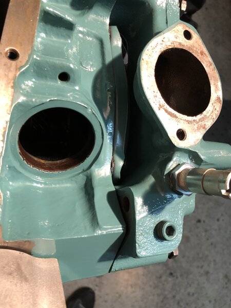

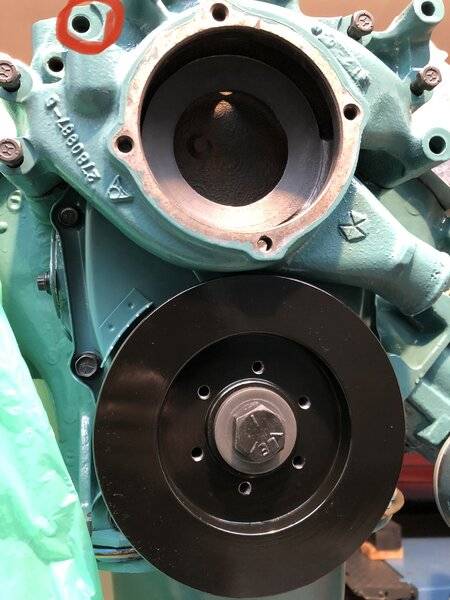

Strange thing.. the top left bolt has no supposed hole with threads in the engine block. The ear is missing on my block but from what I can tell when the engine was bare, unpainted the surface was in that area had cast appearance just like all around.
69 383 block
Has anyone seen this before? Any reasons?
Looks like my water pump housing will only have two bolts holding it to the block on this side..
It is missing part of the casting there. May or may not have an issue with a water leak out the top area without the third bolt.
