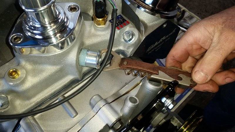

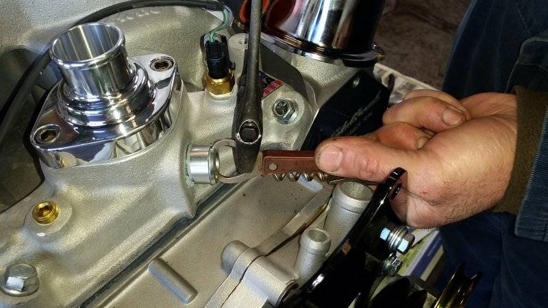

We did this installing into my new engine....

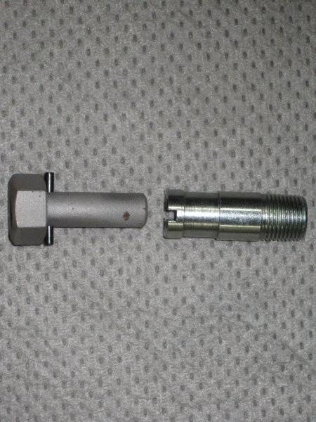

Make one. Cut off the correct size bolt, drill hole, insert split roll pin.
