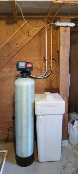

I have 2 Fleck units. The old one is 10+ years old and has been flawless. 1 40# bag a month with our usage and water. I will find a link and post it here. (If I can find it)
I think it was from this place. I bought it a couple years ago for my Son's house and can't locate the paperwork. Boy the prices have gone up. it was around $600 a few years ago. Fleck 5600 SXT On Demand Water Softener
