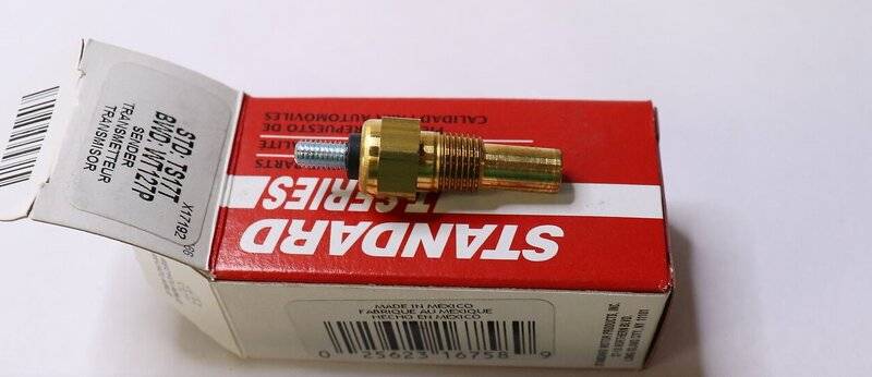

Just go to your local parts store and ask for a Standard . TS17T

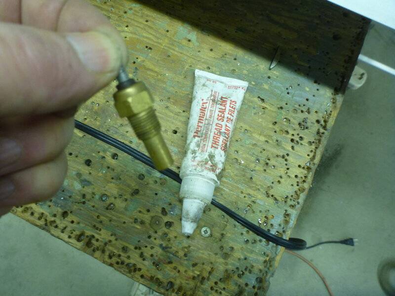

Install tip if interested - use some thread sealer as in dadsbee post and do not over-tighten it.
Only tight enough to prevent a leak.
