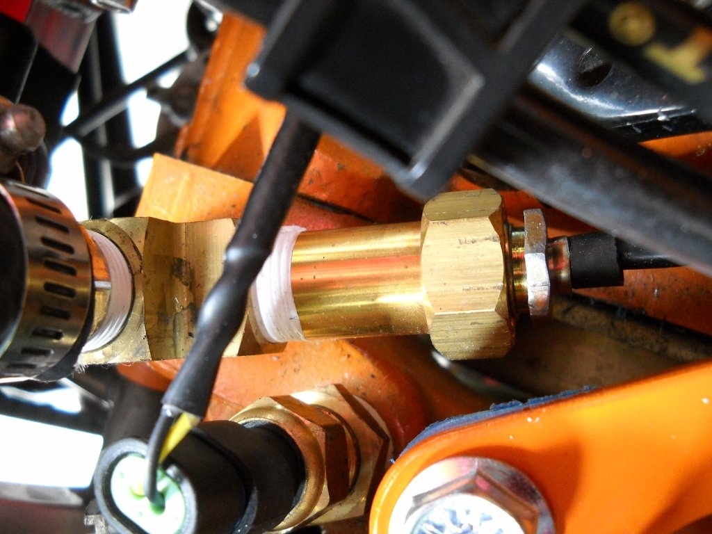

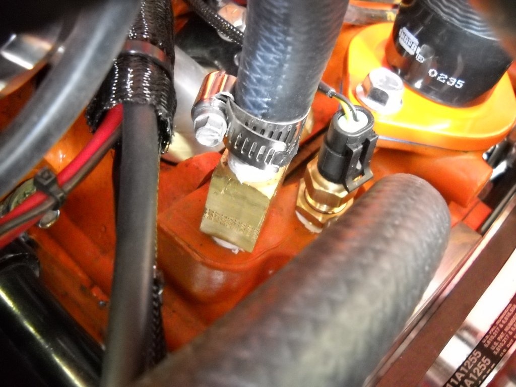

My solution was to utilize a 3/8"pt 'T' in the water pump housing. The heater hose fitting is in the top and the mechanical gauge bourdon tube is in the side hole using a Summit extender (https://www.summitracing.com/parts/atm-2271). The other electric sender is for the FiTech computer:

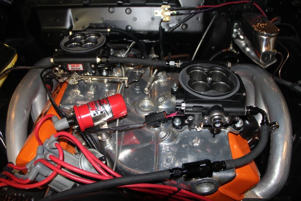

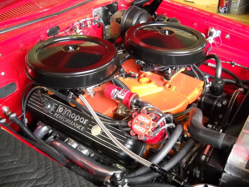

Initially it was, because they hadn't done many of them. Johnny at Pace Performance, where I purchased the unit, was a great help in getting answers from FiTech, whose popularity seems to have outrun their ability to have good customer service. Hopefully, soon they will catch up and publish a comprehensive owner's manual. I've worked with carburetors for over 50 years and my engine ran great with the Edelbrock 500s, but wanted a new challenge. FiTech hooked me with their Fuel Command Center, which made the install much simpler. With all the rain we've had and vacation traveling I haven't put a lot of miles on it, but so far, I'm very impressed.
Did you have to make your internal connection window larger on your crossram Manifold.
No is the short answer. I have the FiTech oxygen sensor on the right bank and a Innovative wide band A/F sensor on the left bank. When the engine is cold, the sensors don't agree with each other but after it's up to operating temperature they pretty much run the same.
What about the block heater bung?
I've always wondered about that.
Does it go into the water jacket?
If so, that might be a better place for the sensor than high up in the intake, as it would be less likely to become uncovered and stop registering correctly.
Block drain plug, didn't think to go low, good idea.

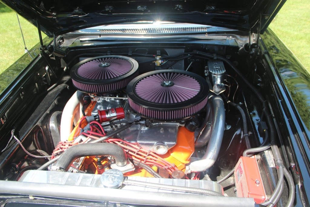

What did you do to make stock air cleaners fit the Fitech throttle bodies. I think that looks a lot better than mine. My base would not fit so I went to k&n 2" filters with air stream top. That setup seamed to give me some more power and now I don't suck as much heat from the manifold and headers. For car shows I would like to put my stock ones back on but don't want to cut them to fit.
Thanks yours looks great
coloradodave
I'll PM you rather than take over this thread.
