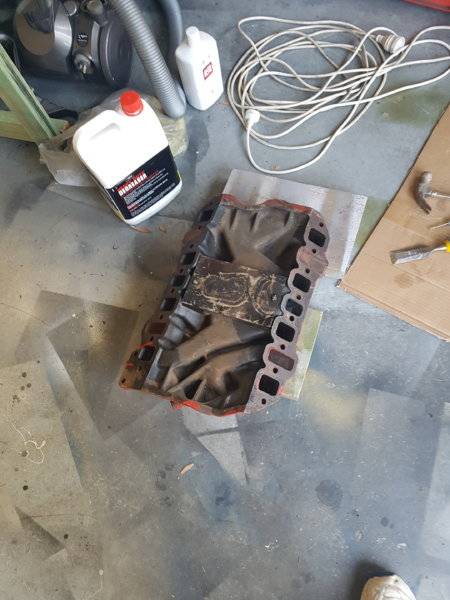

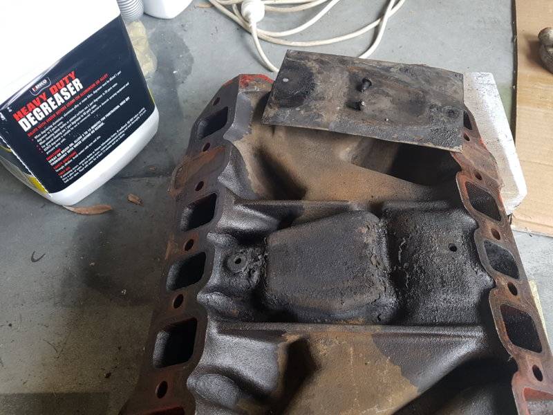

You will definitely need to take the heat shield off the bottom of it has one. Just tap a chisel under the screw heads and then twist them off with pliers. There will be a ton of gunk under there for sure.
https://www.lowes.com/pd/Zep-128-oz-Degreaser/3621246 I've had success soaking super greasy parts in this stuff for awhile. It's really nasty, though, don't get it on you if at all possible. Haven't had problems with it eating away at iron at all, but it warns not to use on aluminum, so I haven't. That should get most off after a day, then take a wire brush and get the rest, spray with some carb cleaner/brake clean if there are some stubborn bits and lacquer thinner for anything REALLY sticking.
