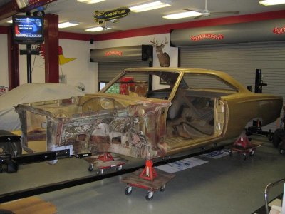

Get some friends over. Most shells can be lifted and set down on pre installed dollies/wheels.

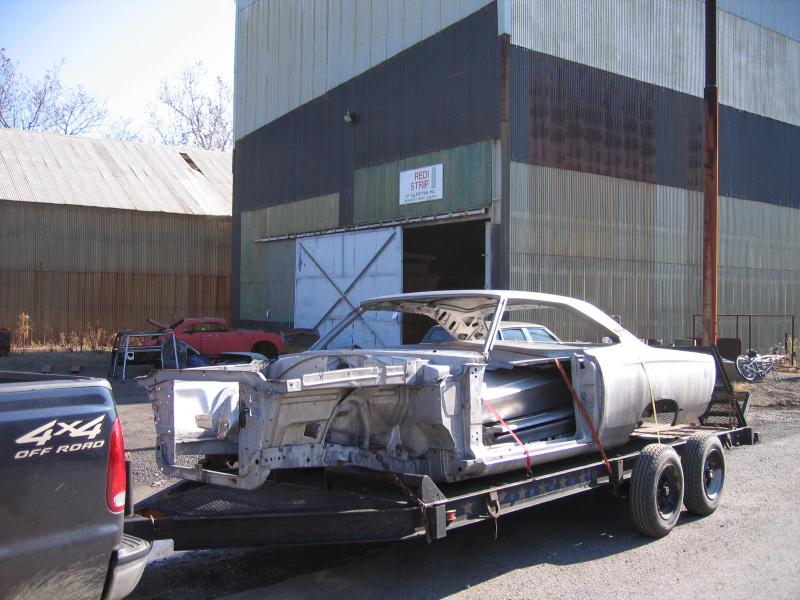

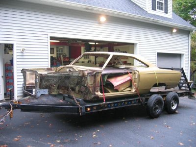

My rotisserie has hydraulics, but I needed to load the shell on a flat trailer to go to the stripper. 6 guys handled it easily.

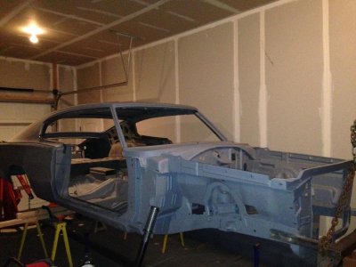

Got it off the rotisserie. Ended up using two engine hoists. The car, and the newly installed subframe connectors are all epoxy primed, and ready for the suspension to go back on.IMG_3949.jpg
