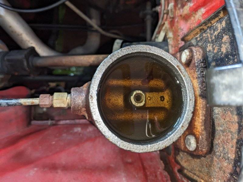

What does the top lip of the master look like? If its rust and pits no gasket will seal. Post a pic with the cover off. Also how full are you keeping it? To full is not good either. Also look that gasket over for age cracks. It could seal but if fluid is passing through it it will still wick out

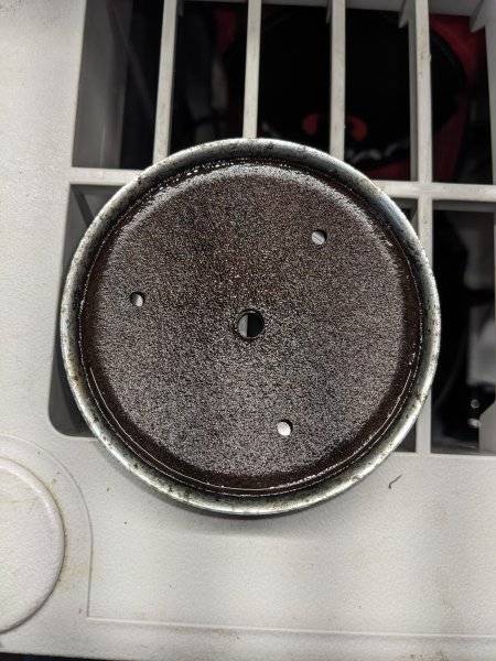

It looks pretty decent - see first pic. I usually keep it 1/4" from top per Service Manual. The last three pics are (1) cover & gasket as taken off, (2) cover and gasket separate as removed, and (3) cover and gasket with gasket flipped over. The gasket is a rather substantial looking fiber material and does not seem to have any cracks around the edge. And, yes, I'm not spending $50 for an NOS gasket though I do appreciate the link!

That top gasket surface is never gonna seal.... Those pits act like a channel allowing fluid to wick past...
you could always try some JB weld "gas tank" sealer, but you might have a hard time getting the lid off for the next fluid inspection........:lol:
Drain the fluid.. suction pump.. syringe or siphon. Pack the reservoir with shop towel. Wrap a piece of 120 sandpaper around a wood block and make the rim flawless. Clean the seal with brake kleenex till it's spotless. Refill and reassemble with fluid 1/2" below edge.

That's an excellent idea. The top surface is "not bad" but certainly not spotless. I did clean as much as I could, flattened the gasket and flipped it over. Then I tightened the cover more than I usually do. Still seeping from top edge but much slower than before. Until I'm ready to take your approach maybe I'll just clean it with Brakleen every so often.

If keeping the old, or even putting a new mc on, put sandpaper on a flat surface, I've used a piece of metal on a workbench or even glass in the past, flip the mc over onto the sandpaper and sand it until it is smooth, then sand it some more.
Clean the cap and mc inside and out.
Get a roll of gasket material and cut out a new gasket, put it over the old one.
I have never had a cap leak after doing this, new or old mc, cause new ones right out of the box can leak too.

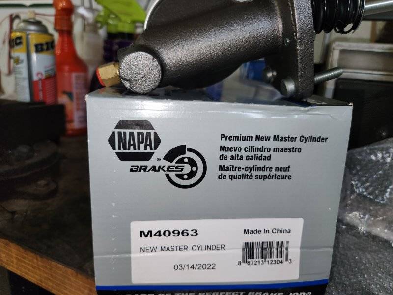

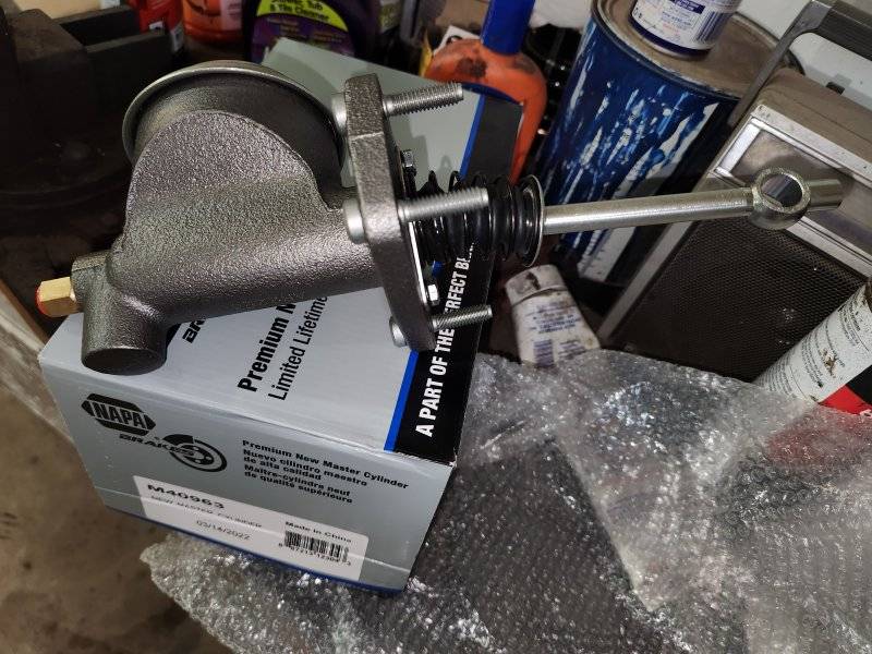

New NAPA Master cyl. $154.00
They had rebuilt also.
Power brakes ones are cheaper but they don't have brake rod. The brake rod can be switched if you have the rubber part that keeps the rod in the plunger part
