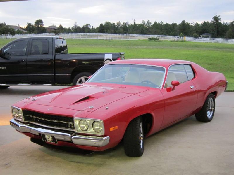

Here is my 73 Roadrunner that i installed HD springs on Last year. It has settled a little but still a tad high for my liking. The superstock would make it even higher and also has an extra leaf on the Pass side. 1011994_1383454665205876_207871559_n.jpg
Here is my 73 Roadrunner that i installed HD springs on Last year. It has settled a little but still a tad high for my liking. The superstock would make it even higher and also has an extra leaf on the Pass side.View attachment 148574
Thats what everyone I called said... Said the Super Stocks are great for the track, not so much for the street... Far too stiff and too high they said. They said for every day driving, with occasional use on the track, go with the HD's, for mostly track use and rarely driven on the street, go with the super stocks... SO, I went with the HD's! Are those stock height HD's on your R/R?
I purchased them from Classic Industries Part Number MR3124 73-74 B-Body HD RR Leaf Springs but they weren't cheap. I believe i paid $449 + shipping so real pricey. If I remember correctly i had to use 1972 mounting plate because the center hole and in 73 rear spring isolators were used.
