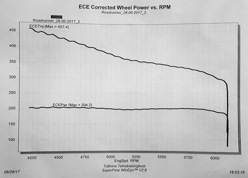

Tryed dyno pull yesterday with my 1972 Sixpack RR . Started at 4000 rpm, torque converter is 3500 stall Streetfighter. Kickdown linkage is disconnected and 3-rd gear used. Rev. limiter is 6000. I think somewhere is major misunderstanding . Somebody seen curve like that. Power is in kw...that is approx. 270 rwhp.
I would think that with the kick down linkage not connected it would be slipping some in high gear under that kind of load. Torkflite transmissions need that linkage connected and adjusted properly to function correctly. Not an expert here but I've never seen a pattern like that. JMO
Looks like it drops off power wise after 4000 rpm
it ain't liking that specific combo...
Shouldn't drop off that drastically after 4000 rpm
maybe after 5500 or so, but not that much...
just spit-balling here,
not knowing your specific combo;
They should fall of a bit in HP even a little TQ
after reaching the camshaft power range
& what the valve-springs will handle
or what the uintake carbs, heads, valves,
intake & ex. ports can flow
but that's like it's starving of fuel or way too fat
or ignition timing way off, ignition curve way off,
the coil or resistance wrong etc.
Probably something not getting power to the rear axle
trans &/or converter or even gear ratios, is killing it
bogging it down etc. or something is obviously way off...
What kind of shift kit or valve-body ? If any ?
The kick-down/Throttle bypass linkage,
should be hooked up other wise, unless it has a kit
or valve-body that reroutes the fluids...
That is a strange graph...
More details on what's been done,
may help diagnose it better...
I'm not a big dyno guy either...

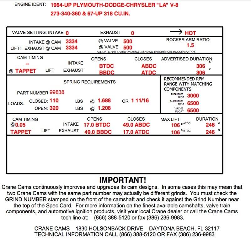

summer so its only for show. Cam is Cam Dynamics with unknown specs.Some numbers stamped in the end of camshaft. Yesterday i write to cranetech and asked some specifications and here is answer:
We don’t have a spec card showing the 306H for the B Mopar, but I was able
to find a card for the LA engine. The specs will be similar to the big
block.
