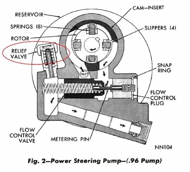

been a while since i worked on ps. is there a presure valve in the pump? most do not come with rebuilt pumps.or is it built into gear box? there has to be one someplace in the system.
I was thinking there was a relief spring built in...I may be thinking of a gm...Heidts makes an external regulator you can bolt to the frame. It will however require some custom lines...
Maybe you had filled too high or it needed to burp out some air? You never want to turn wheel against the stops for too long, it up's the press way up.
OK gentlemen, I found the answer.... the gear box itself is bad. Yes, the pressure regulator is in the pump itself & screws into place into the pump right before the high pressure hose which screws into it.
