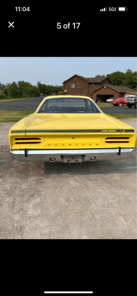

Hello all new poster I just bought a 1970 Road Runner trying to make it as factory correct as possible. Purchased a new exhaust for it and from the factory no exhaust tips. I see road runners without exhaust tips the rear tailpipes come straight down.
the tailpipes that i purchased are kicked to one side on a angle is that correct? do the pipes come straight down under the bumper. thanks

if the car was org. sold in *Calif. "it will have *turndowns" from the factory
*tailpipes hugging the side of the fuel tank & straight out the back (On all the cars)
the Calif. car *turn downs exit just behind the rear bumper.
(straight out along side the fuel tank also)
48 State cars could have the fancy chrome & red tips (edited; that was 1971), (not sure about Hawaii cars)

a 70 could have chrome tips, the machine-gun tips were introduced on the 71 model year

In Calif. they had to have 'turn downs' if they were bought or even built here
