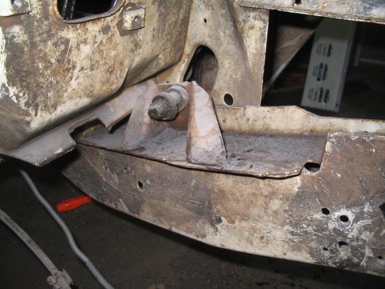

You mean this pic?

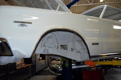

I can't tell in the finished pic if it's still there.

I don't drive anymore because of my eyesight. I must have missed it. That is the frame bracket I was talking about. Is it still posted? I have to enlarge the photosl and I did not see it again.

I noticed in the bare metal shot that the said bracket is no longer there. and, yes! wow what a car. super nice!!

I'm suspicious of this car myself,,, The worn paint and amount of surface rust looks the same on the bracket as it does on the rest of the surrounding areas.... I think its funny that their are no signs of this being added later in its life....
It wouldn't be the first time a "restoration" company has used another body and transfered all badging over and claimed they restored a car! Looks like its welded the same as mine too....
