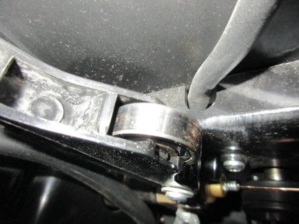

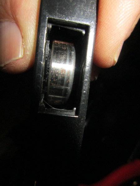

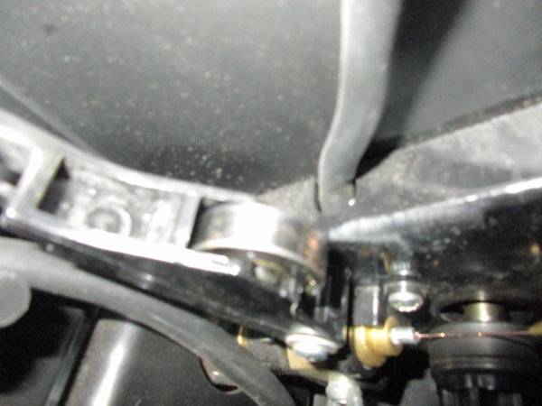

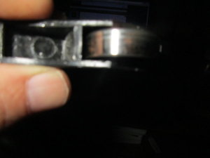

Haven't found an issue with the gas feed yet But I did find an issue with the roller. It has pits and rust spots I will have to get a new one and go from there.

You can just polish the rollers with a fine scotch brite pad. Make sure your wire hasn't started to rust. It will if the humidity has been right. Then the rust comes off in your liner. If your bottle has sat for a long time you can roll it like I mentioned in my last post.

got a picture of the front of the machine? does the wire bind at the roller?

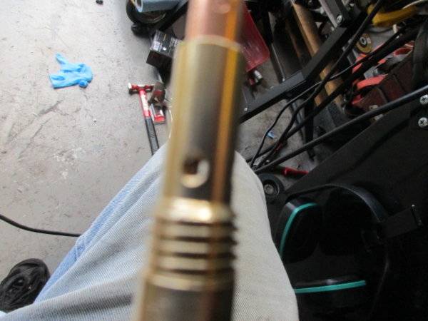

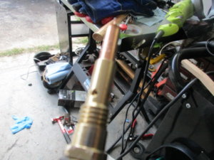

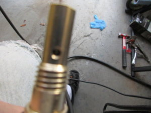

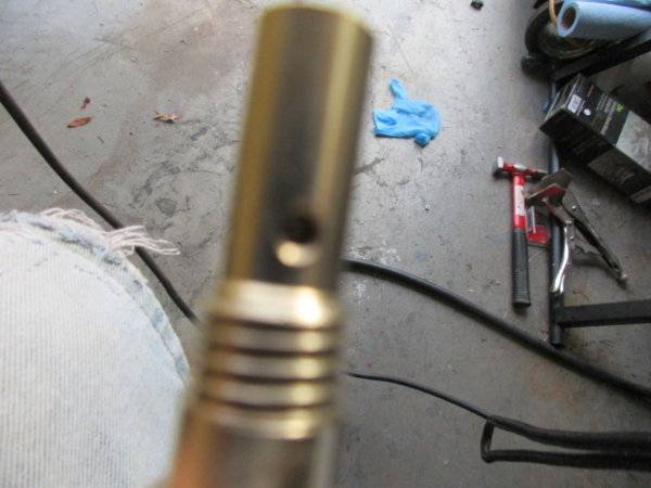

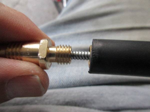

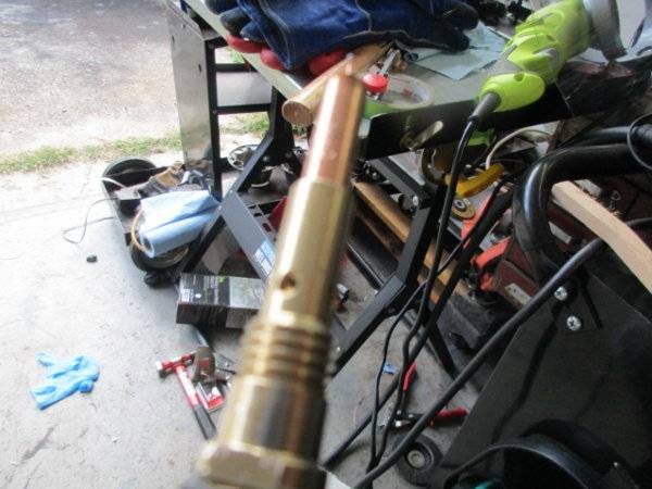

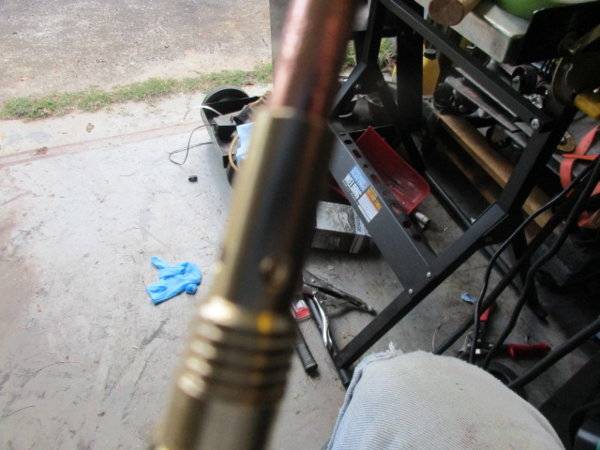

Update Sorry I haven't posted an update yet. Been sick since last week. Well I got a new Gas Bottle I dicided to take the Nozzle off just to check the gas and see If It was feeding. Found that the spring inside the cable is riding up into the diffuser and blocking the gas holes. When the cable is moved around. It looks like I will have to get another Trigger cable. I also have to work on my technique a bit

You don't need to do that. The gas comes into the nozzle around the outside of the cable. It shouldn't be blocking the flow even though it's in there. Put it back together and try it again.
In other words, it's supposed to be in there like that.
