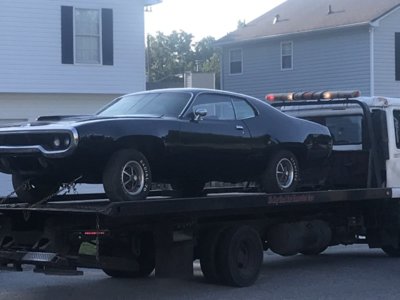

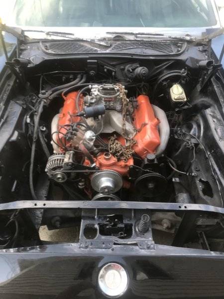

Reluctantly installed my 440 into someone elses car. Its a sad day for me. However it went in with no issues. Tomorrow I will wire it up and get it buttoned up. He will need a hood/scoop or swap out the M1 to a dual plane intake. Either way it sits up in the 71 Satellite.

it lives on :thumbsup:
someone will enjoy it :bananadance:
looks good in there too :drinks:
I have a few stock style intakes around if he doesn't want to cut the hood.
The hood on the car is a disaster any way. It had a glass scoop grafted to it and its missing the inserts and callouts. I told him for weeks the M1 was going to stick up and he was either going to have to cut up the hood or find a flat one and put a 3 inch scoop of some sort on it. So he had that ugly *** hood painted anyway. Well they never listen. We will see what the outcome is in a few days.
