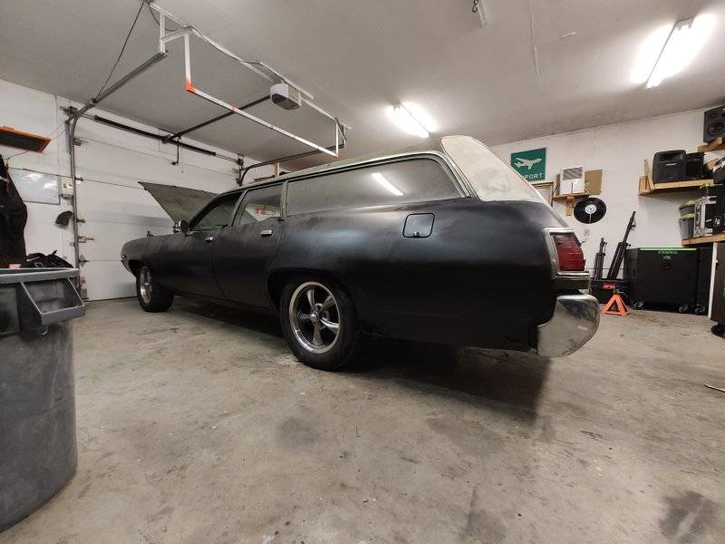

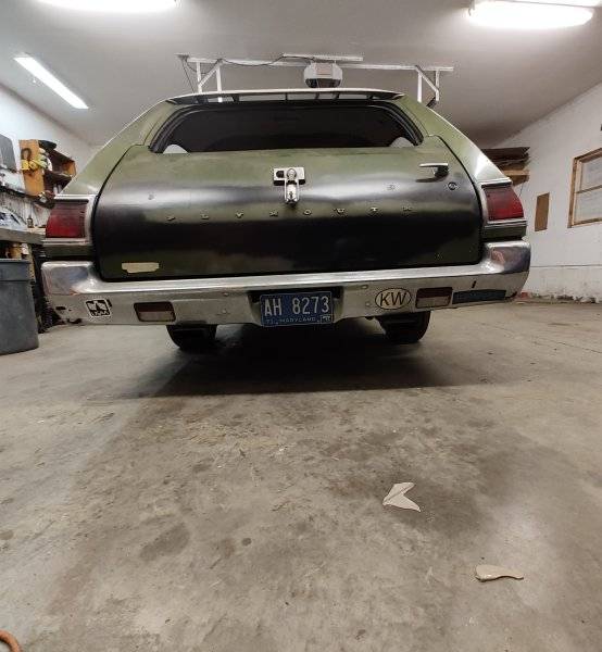

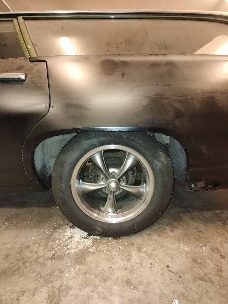

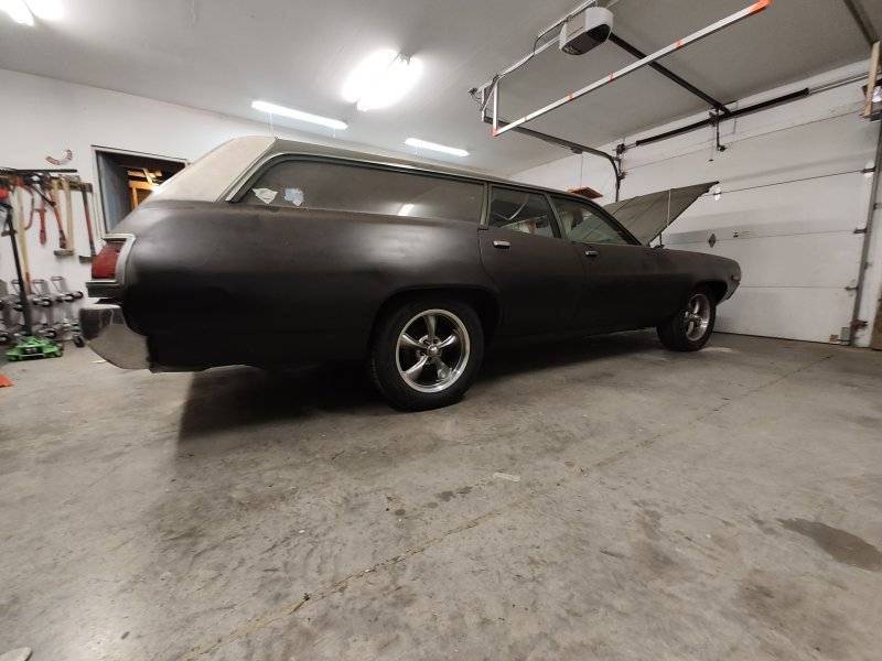

So here's the rear view
Passenger side
Driver side
And that's all with totally dead air shocks.
