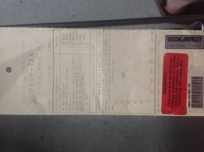

Yes, they are 78-80 amps. I have the output chart somewhere of one rebuilt by Beck-Arnley. When I find the file, will post.

I couldn't find the pic on my PC but since I have uploaded several times, it can be found already uploaded at some other Mopar boards
