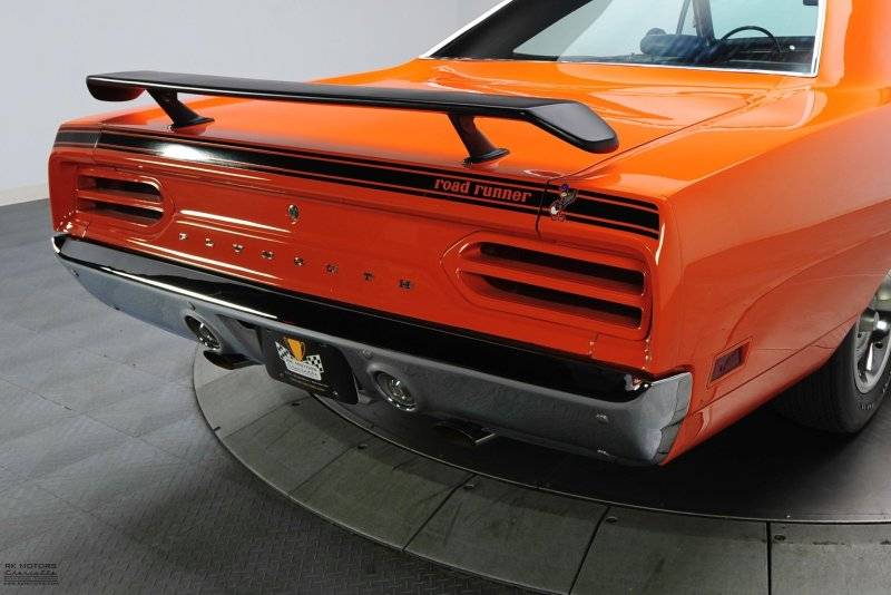

So what’s the deal with the rear spoiler on the 70 Roadrunner? Was that a Chrysler dealer option or just an aftermarket thing? Is there any history on this? I wouldn’t think it provided much functionality. So purely aesthetic.?.
It was an option, but wasn't available right at the start of the 1970 model year. It was introduced after a few months, and the trunk lid stampings were changed to reflect this; besides the outer skin mounting holes, the later inner bracing has the holes meant to secure the inner wing brackets while the early lid braces are smooth. My road runner came with the wing, I have trunk lids in both versions.
I don't know for sure but it may have been option code A45.
(edit) moes pointed out that the correct code for the rear spoiler is J81. A45 is a different package; the factory rear spoiler plus added dealer installed front spoiler.
The actual factory name for it in 1970 was "Rear Spoiler", and for 1971 it was called "Aerodynamic Rear Spoiler", with the same code.

it was an option available J81 from the factory. No functionality, it was added for looks only. Some people like it and some don't.
To keep us all on the same page, that is not a spoiler. A spoiler does exactly what its name implies, it "spoils' air flow, and creates a relatively high-pressure zone wake upstream of the spoiler, causing in most cases downforce on any nearly horizontal nearby surface. It's main downside is an increase in drag. In some certain circumstances an angled rear lip "spoiler" can also reduce some overall drag by helping air reattach after flowing over the spoiler. The rear window optimized almost flat recent SUV lips are not spoilers but reduce drag. Otherwise, air only flows and acts on one surface of a true "spoiler".
Marketing types will call anything that helps sell their product anything, accurate or not. Don't fall for that hype.
A wing, pictured, effects air on two sides and by its shape, size, and angle of attack, generates different air speeds on opposite sides and resulting in a pressure differential which generates a force that the "wing" generates. In a plane its lift, in a car its intent is downforce. It must have air movement on both sides. It's design efficiency is often qualified by the wings lift/DF vs drag ratio.
