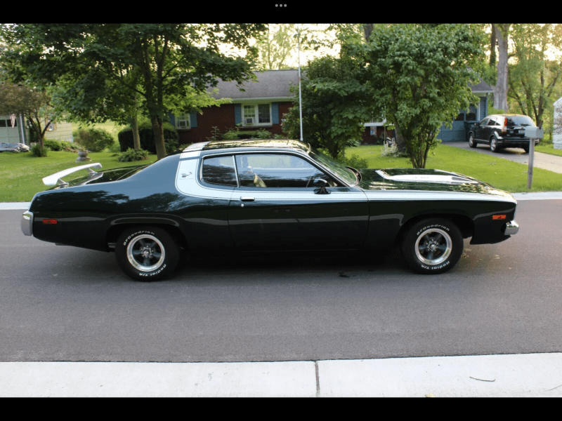

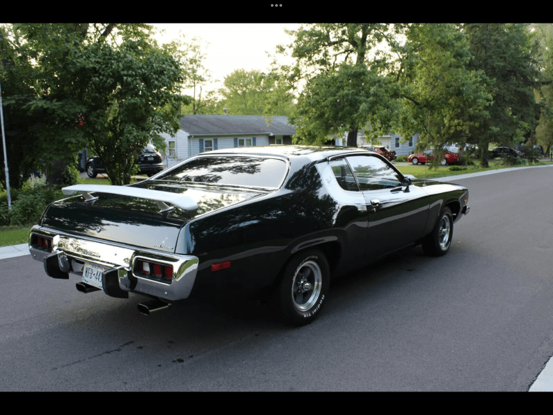

What’s with the rear spoiler?
That color makes the body pop. :thumbsup:
Yeah it took me a long time to get the color on my car the way it is. It’s a custom color. It’s very close to that Chargers.
I don't recall that color ever being offered on B's or if it was it wasn't very common.
I have seen on lots of A body's. It looks good on a big car, relatively.
it was an option available J81 from the factory. No functionality, it was added for looks only. Some people like it and some don't.
I agree, it doesn't add to the look. I would never add it and if I bought one that had it, I would remove it.
Can't decide if I want to remove the front trim rings or get another set for the rear. I bought one set for the rear and they would not fit. They were supposed to be the correct ones for these wheel vintiques 15x8 wheels from them, but I could not get them on. Actually bent one trying so I couldn't return them.
If you want an opinion, lose the trim rings and hub caps along with the spoiler.

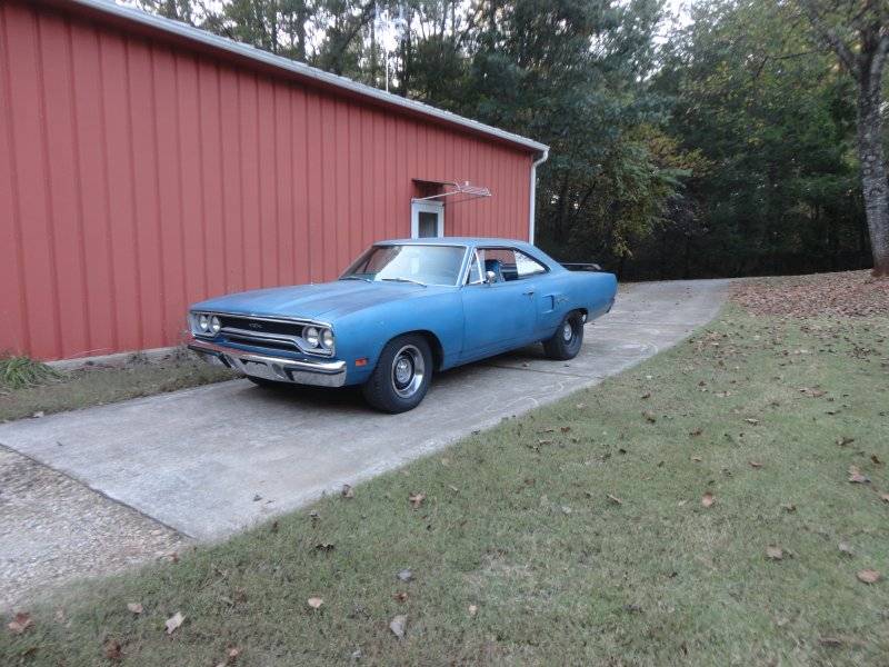

See how cool a car looks with regular black wheels....

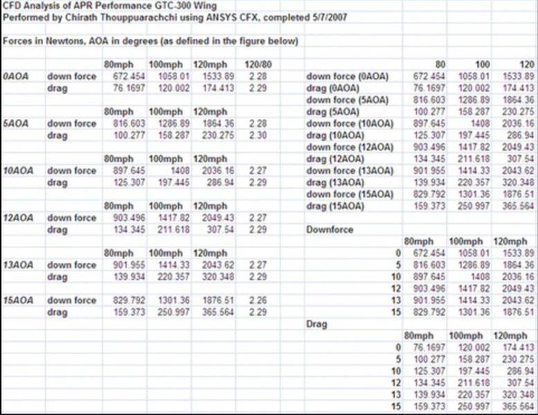

I should add to the conversation, any "real" wing at speeds driven over a hundred miles an hour can load its support structure with many hundreds of pounds load, far exceeding the safe load capacity of most trunk lids. True real racing wings are seldom if ever stock trunk lid mounted.
Of course, if you never drive at high speed or have a truly designed functional wing, this concern does not matter.

And 2049 newtons above at 120 mph is approx 460lbs DF

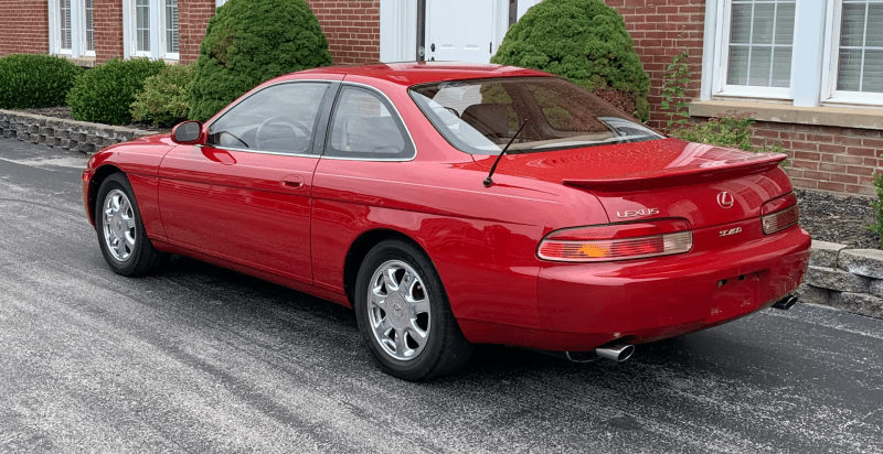

Sometimes it's all for looks, and sometimes there is a benefit. For example, the Lexus SC400 had an optional rear deck lid spoiler, and the aerodynamic CD rating for the car without the spoiler is .32, while the option lowers the rating to .31 which isn't a lot, but enabled the car to reach a true 150 mph. I have one of these cars.

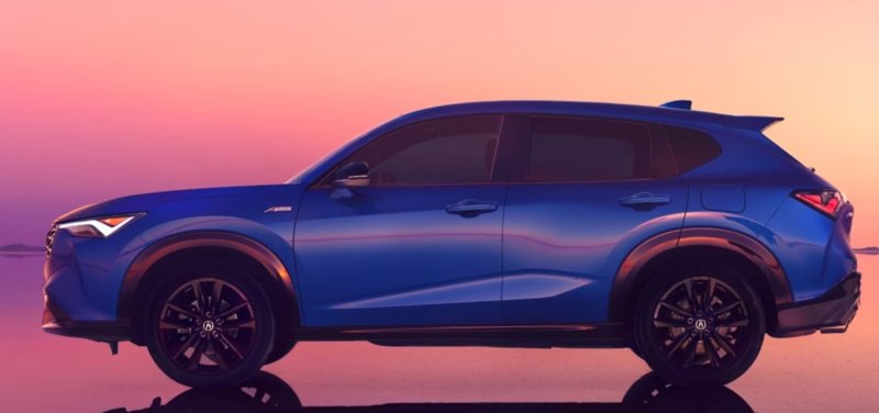

However, that does not really "spoil" any airflow, and as I mentioned in reply #7 on this thread its purpose is to primarily to better reattach upper body exiting rear airflow lowering drag. It's a takeoff of the aero "box cavity effect", a better implementation for vehicle use is lately seen on the large flaps of OTR on the rear doors semi-trailers, and extensively seen on nearly every current SUV rear window lip.
