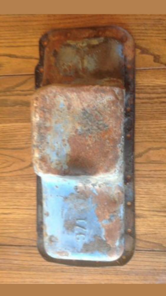

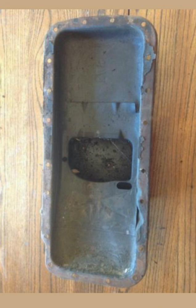

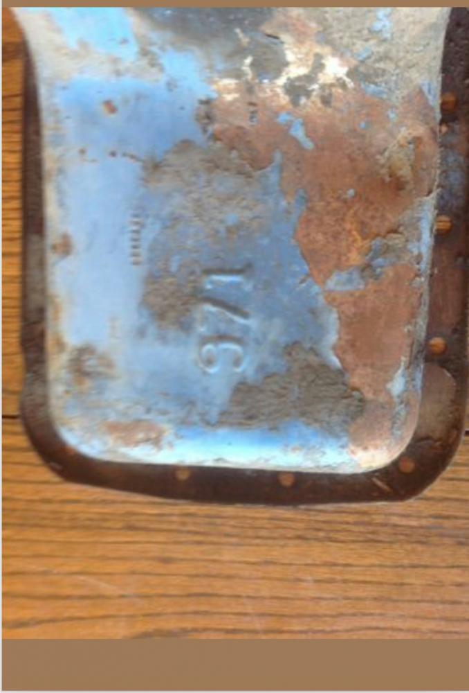

Found this original 971 pan on eBay. Doesn't have the reinforcing between the bolt holes either. Guess the new one is a good reproduction...
Yeah. Including the one piece baffle. The newer one is re-shaped at the front of the 'pot' for clearance at the K-frame.
