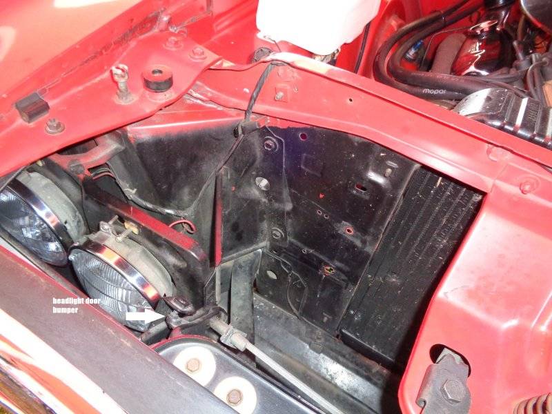

All 1970 model cars with concealed headlights had to use an electric motor to open the headlight doors. It was Federal law.
The headlight doors pivoted from the center and were opened by a stainless steel rod that was driven by a single motor mounted below the latch support. Look closely, you'll see the silver/gray colored rod that is bent sort of like a banana. The horizontal red arrow ends right where the door motor is.

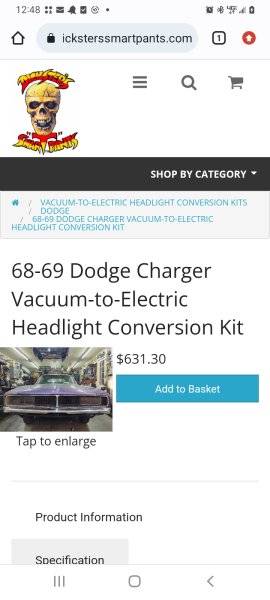

This is the last question. I found a 1969 to electric motor conversion kit. My question to you guys will this work on a 1970?
