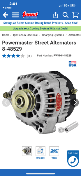

This one.
I have been using this one and have no complaints whatsoever. It has outstanding low RPM output as well as increased overall output. Obviously I made required changes so that I wasn't passing through the amp meter. I actually had already switched to a Ron francis conversion for electrical before I switched to this alternator. It's a really nice unit, and has visual appeal as well. 10 years, no issues.

I’m in the process of upgrading to power master 165 A one wire , I’m looking to take load off the ammeter and I also know I have to do the bulkhead bypass , I’m also doing the “ big 3” upgrade under the hood using 2 gauge cable . I’m also putting a 200 amp manual reset fuse / circuit breaker on the power cable from alt to bat
Any input or advise plz

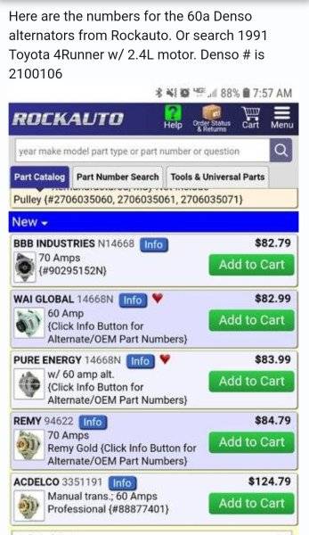

Denso internally regulated.
