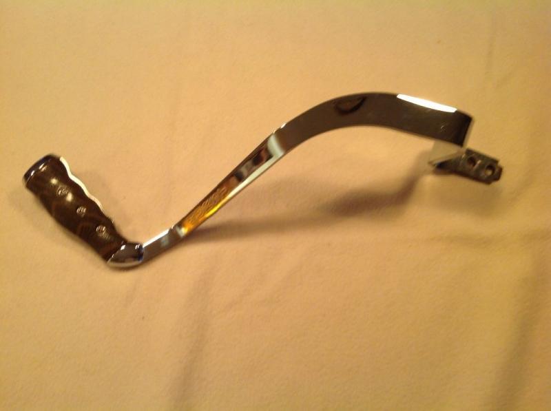

Does anyone know what the console 4spd pistol grip shifter is supposed to look like? I have the short straight one, but someone told me its supposed to be a long curvy one????? Thanks
This would have the longer, curvy shifter. I call that the "dash slammer". Coolest-looking shifter in any Mopar, IMO!
Thank you, of course that is the one I don't have and the more costly of the 2, lol...

Heres what the dash slammer looks like. in the 80's & 90's they were easy to find, now they are rare find. I do beleive you can get reporduction now.
{ATTACH=CONFIG]261053[/ATTACH}
Thank you, it does seem they have repops available, I need to buy one of these now, or well in the next couple years I take finishing this car....
