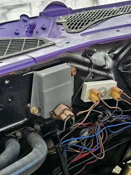

I'm thinking about three daunting task of rewiring my car, however it would be nice to clean things up a bit. What are these items on the firewall? Can they be removed?
I am getting FBO ignition box which gets rid of the ballast resistor, so thats a start.

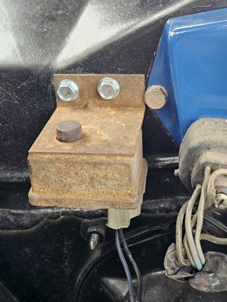

What is the grey box, and the rusted box?
Thanks!
The gray box is the ecu or electronic control box. That can be replaced with a msd ignition box. Not sure what the rusted part is.

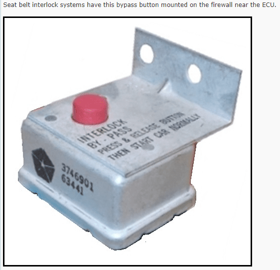

Gray box is your voltage regulator. It could be relocated or if you use an alternator with internal regulator the OEM one can be eliminated. The rusty box looks similar to the seatbelt interlock bypass switch but it looks different from the one in my '74 SE. If it is indeed the bypass and you intend to do away with the interlock that too can be defeated and removed.
Rusty box reminds me of a circuit breaker I’ve seen in the past. Can’t say for sure though
Oh wow! That's a button? Lol.
What the Hell do I do with that? Weird.

Everything you never wanted to know about this system. You're welcome.:lol:

The rusted box appears to be the bypass relay for your seat belt interlock system. This was a Federally Mandated requirement on all cars starting with the 1974 model year to encourage seat belt use. It was not a popular move with the public at the time. The outcry against it was so great that Congress rescinded the mandate the next year (1975) and the seat belt interlock system was discontinued. If your car is a 1974 model (and it would have to be to have one of these relays) I would say if it still works as intended, then keep it. If it has failed however, there's no harm in removing and discarding it and taping off the harness. That is what I did with my 1974 Dodge Coronet. You won't get into trouble with DOT. To be honest, I don't know if parts are even still available to fix this system anymore.
Careful on advice you get on the internet. Some of the guys here are very smart and others do not know the way up.... Heaven forbid if you hook up a MSD ignition control to your alternator for a voltage regulator. I would love to see the results. :):)
