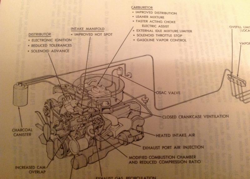

The one on the right is the OSAC valve.
The one on the left looks like either a fuse/circuit breaker or electronic resistor for some other device. It is not a stock part. What does the writing on it say and what is it connected to.

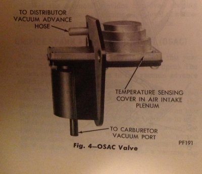

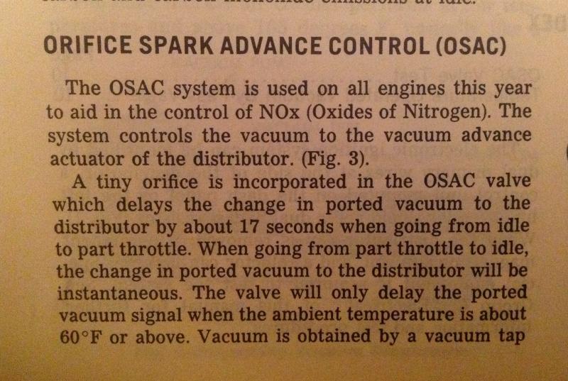

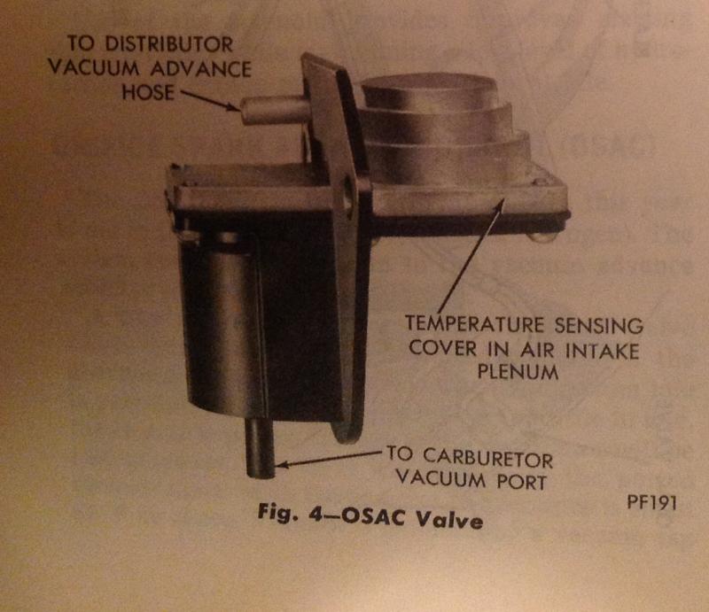

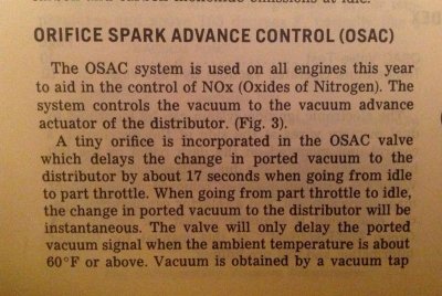

Here are some pictures from the service manual.
The OSAC valve is connected by hose to the carb and to the distributor advance. Its function was to delay advance of the distributor during the 1st 10-15 seconds of acceleration.
Thanks. Super, now I understand why it was never connected and what it did....the PO switched the carb out for a Summit carb and
there is no place to connect it as I see it. Also, I can look it up and read about it.

vacuum hose
There should be a vacuum hose coming from the carb to the distributor now. The OSAC valve connects between the carb and the distributor. The valve was originally labelled to which connection was for carb and dist .
I will look the next time I go out and connect up between the carb and dist.
