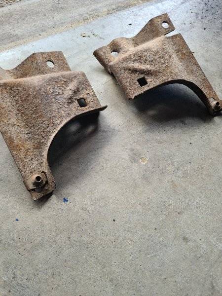

Anyone know where these go, or what they are?

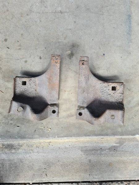

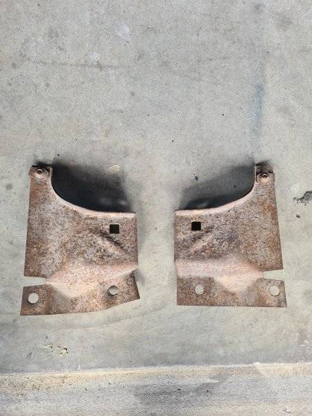

My 68 Charger project came as a shell with a bunch of parts in the trunk. Some are from a 69 and a couple are from a challenge, I think. Is be very grateful if anyone can identify what these are as I've no clue. Thanks in advance!!! Dan
The pictured items are rear bumper guard brackets which also serve as braces and exhaust hangers.

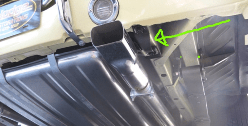

They were used on 1968 - 1970 Chargers. Following is a borrowed image showing one in place:
Brilliant!!! Thanks Vaanth! My fuel tank came in the trunk so I had no idea where to even start on these. Very much obliged thank you! Dan
