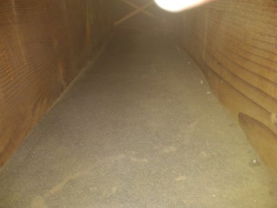

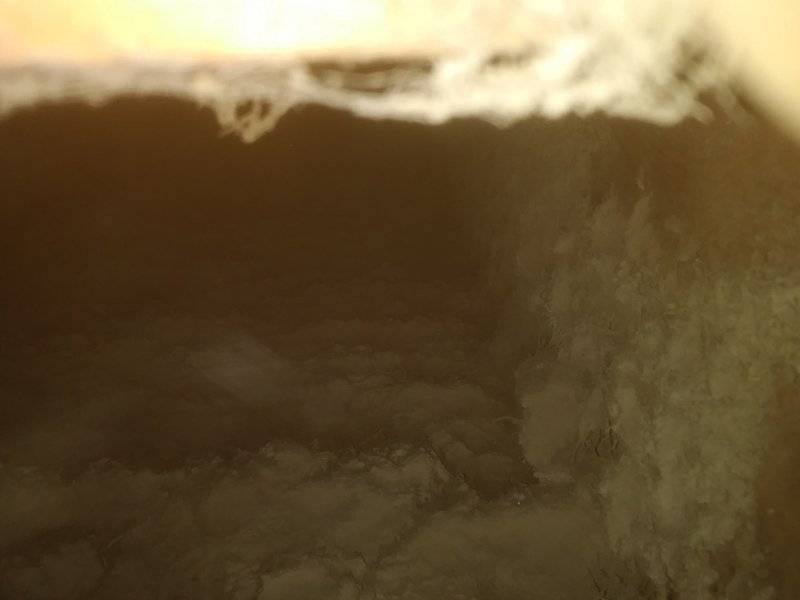

Just thought i'd share a couple of pics. These are of a joist space, in a recent customers home. This space is being used as duct to pull return air back to their furnace. Its common for air duct cleaning companies to have " touched up" photos showing their work. Though these are completely untouched. This is typical of what i see in many homes. This is a buildup of skin that people shed, dust mites, dust mite feces, and pet dander. Changing your filter regularly helps in keeping the air in your home clean. Though this still builds up, especially in the return duct.

Man that's nasty. I never knew those could be that full of crud. I kind glad I have electric baseboard heat. But it's expensive to heat with.
There were a ton of for sale ads posted, right after i put this up. So i dont think many people saw it. I just thought people should be aware.
Why I have always had filters placed over all the return vents, since building our house 25 years ago. But that would put you out of business... lol

Ive seen joists used for returns in older homes. Maybe to save money with not having to use ducts?
using the bay space for return air is still a common practice today.
easier to pan off a bay than run duct work for returns in certain applications

Filters dont stop everything. Putting filters over every return puts too much stress on the blower motor, it raises the amp draw of the motor, causing it to have a shorter life. It also raises the delta of the furnaces operating temp range. and restricts air flow.
I've also seen people put filter material under supply registers, which does the same thing.

I built my house in 2006 and we used the joist space as a plenum for cold air return.
I’ve been told recently Ohio building code no longer permits that.
