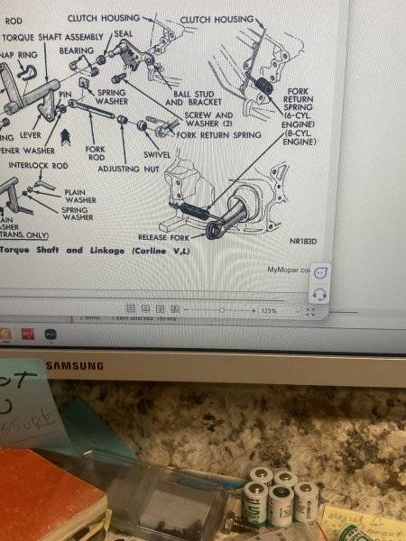

I should add that I don’t use the over center spring.
I only have a spring from the fork to the bellhousing as shown in the photo below from the fsm. I never have to lift the pedal with my toe.
You must have the "fork return spring" to pull the throw out bearing back after a gear change. The linkage isn't attached to the release fork. It's just a rod through a bushing. I think the over center spring is just to ease pedal pressure with a stock type Borg and Beck clutch. Has yours been replaced with a diaphragm style pressure plate? They don't need a over center spring with those.
My linkage now is homemade from the pedal to the fork. I’ve used all three types of clutch, a Long style now.
I tried putting it back to stock parts last year but I just wasn’t happy with the result.
Yes, that spring is in place on Fred as well; it's whole purpose in life is to hold the throwout bearing off the fingers
of the clutch (via the fork, of course) and that's it - it has nothing to do with pedal return.

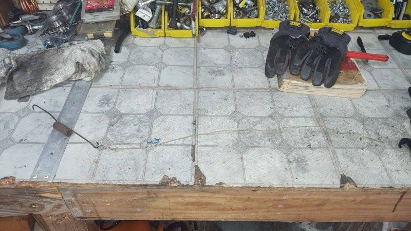

Oh, before I forget...
Here's the "apparatus" Mr. Chicago had "installed" on the z-bar tab and run all the way up to the motor mount,
passing tight under the starter in the process:
Yeah, I'm thinking it wasn't much help. I'm sure he meant well.
At least I got a free carb spring out of the deal. :)
