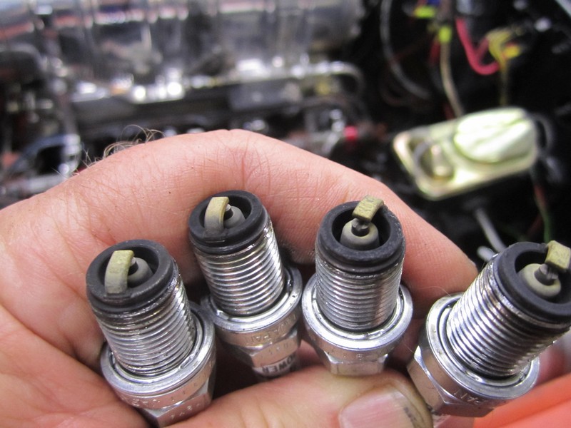

Just wondering if anyone is or has run the newer tech plugs? Platinum, iridium ect. Would they help or hurt?
