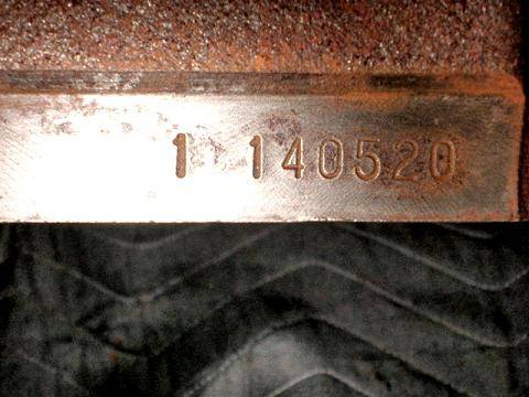

And what do you suppose this is from ?:D
Do we know for sure it is from a car?
If yes, then throw me a bone. What's the CID and EAD? HP or not? R or P in the engine serial number? From that you can narrow down the plant which decreases the possibilities of what it could be from.
I.e. 340 narrows the plant then you look at VIN range.
I.e. 360 narrows it to C bodies.
I.e. 440 HP eliminates an Imperial and with that VIN may eliminate Hamtramck and Jefferson plant.
Based on that, and other info on the block, one might be able to tell what it came from or you can certainly narrow the possibilities.

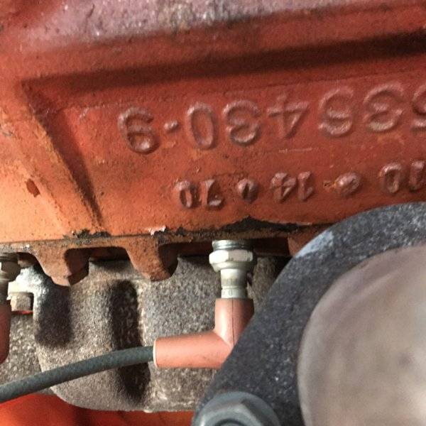

The engine date stamp on the drivers side of the engine reads 10-14-70. But the stamp on the passenger side states it as a71??
71 model year which ran from Aug 1970 to July 1971. So an October cast block would go in a 71 model year car.
