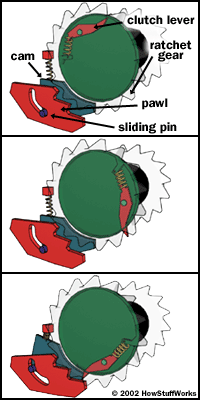

The second kind of system locks the spool when something jerks the belt webbing. The activating force in most designs is the speed of the spool rotation. The diagram shows a common configuration.
The central operating element in this design is a centrifugal clutch— a weighted pivoting lever mounted to the rotating spool. When the spool spins slowly, the lever doesn't pivot at all. A spring keeps it in position. But when something yanks the webbing, spinning the spool more quickly, centrifugal force drives the weighted end of the lever outward.
The extended lever pushes a cam piece mounted to the retractor housing. The cam is connected to a pivoting pawl by a sliding pin. As the cam shifts to the left, the pin moves along a groove in the pawl. This pulls the pawl into the spinning ratchet gear attached to the spool. The pawl locks into the gear's teeth, preventing counterclockwise rotation.

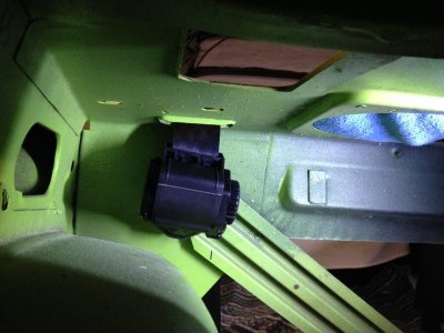

The reason that I asked about this was that I was curious if it mattered how the retractors were mounted.
For example: If a set of belts and the retractor were mounted like so:
......Would they still work the same if they were rotated 90 degrees and mounted in the C pillars? I'm curious if they are directional.
Yes it matters.. Ever been in a car with seat belt retractors when the car was going down a steep grade? There's no deceleration but the seat belt locks due to the angle... Because the pendulum gets far enough out of plumb with the mechanism to lock the spool...
Yes, I have seen that....belts that lock up in the wrong conditions.
The 73-76 A body 3 point belts are hit and miss. They sometimes lock even when you're sitting still and just getting into the car.
I've thought of getting belts from a newer Charger or Challenger but they mount the retractors sideways. If I needed a new headliner that might be cool to integrate in the C pillars but the red car of mine has a decent headliner in place.
I've had pickups that must of had a heavy pendulum because it would lock me in place when I tried to grab something on the dash to keep it from sliding to the far right on even a mild turn to the left. Another pickup was perfect in the fact that didn't happen but would lock up on a harder stop or turn.
