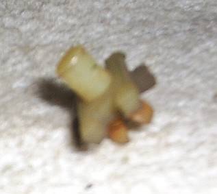

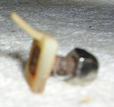

I had all sorts of problems with this and took a long time to locate but eventually got thru with some luck as well on my 63 ply. I ended up with a whole bunch of new molding clips I didn't need. Do you have any photos of the clips you need with measurements?

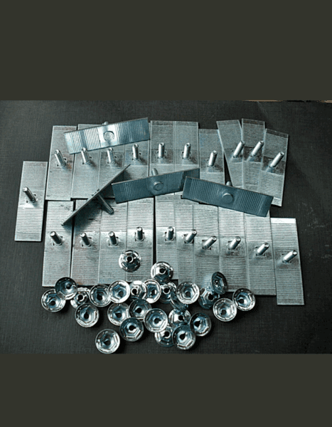

http://www.megapartsusa.com/proddetail.asp?prod=132-STCS159
Original part #s are as follows:
Clip 6001910
Clip w/nut 6002053 - nut 6026523 (which is just an open ended acorn nut) These go on the end(s) of the moulding.

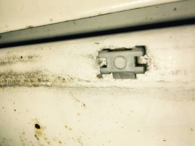

I was amazed at how many different friggin clips were used on my car and ran into a buzz saw with 6 H type clips for the quarter window (three on each side) trim using offset nubby's I NEVER found. I ended up getting lucky here finding another type of clip that worked perfectly. There are many of these nylon clips though to be found but a matter of ensuring the correct sizing. I ordered some clips from an outfit Altha Fastener www.althafastener.com and another outfit Henry's Warehouse. I also got some clips from a place in WI that had a booth at our Jefferson WI meet and can't locate their card they gave me but stocked H clips close but no cigar for my need. If I find their contact info will send along. My hassle was getting these type of clips with an offset nub but several having a centered nub could be had. If I recall Henry's has a catalog you can download and amazed by the ton's of various clips, screws, etc. to be had. Another source could be member Joe Suchy as he has a ton of Mopar parts.
Thanks everyone for the input, I ordered the kit from megaparts that ODZKing posted plus I ordered these other break off trim clips that I found. Hopefully all works out. I'll post pics at a later date with my progress. I posted a pic of the clips that I ordered from ebay. They look like the can work for multiple applications.
